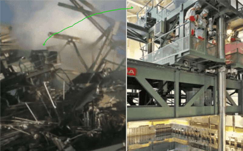

Unit 4 was in a maintenance outage. the green crane to the right was probably a maintenance crane for doing work for equipment in the dryer/separator pool. When a BWR enters an outage, the Rx vessel needs to be disassembled to get access to the Rx fuel. firs the drywell head is removed (thats that big orange dome structure you see in the U4 pictures), then the Rx vessel head insulation, then the Rx vessel head is removed. The drywell head, Rx head insulation and Rx vessel head are stored on the refuel floor.
Next the Rx steam dryer and then the Rx steam separator are removed from the Rx pressure vessel. These items are large and have some level of contamination so they are stored in a large swimming pool/pit.
@michael20
The damage to the lower levels of both Bldg 3 and 4 have been puzzling. I think I know how hydrogen got into the lower levels of Bldg 3, but I am darned if I can figure out a mechanism for the apparent blast in the lower levels of Bldg 4 resulting from hydrogen formed in the SFP4.
I did just read one interpretation that "hot" spent fuel rods were in the accessory SFP4 (what is the proper name?) and that the smaller pool adjacent to the larger SFP4 was damaged, breeched, and dumped glowing hot fuel rods, accounting for reports of recurring fires in Bldg 4.
  • #2,507
TCups said:
Even the strength of the blast at Unit 3 did not blow out every single wall panel of the floor below the top (reactor access) floor. And the top floor (the top two tiers of columns) is where hydrogen was most likely to accumulate. Not only did the explosion at unit 4 take out every panel on the east and west side of the building of the floor below the reactor access floor (ie, at the same level as the SFP), it also appears to have taken out one south side panel a floor below the SFP (ie, two floors below the reactor access floor) and also, it did much less damage to the roof beam superstructure than did the blast at Unit 3, and it left the north wall of the top floor partially collapsed inward, and it left at least two panels on the east and west sides of the top floor intact. Compare, carefully, the east, west, and south elevation views.
http://nimg.sulekha.com/business/original700/aerial-2011-3-30-1-11-12.jpg
http://nimg.sulekha.com/business/original700/aerial-2011-3-30-0-20-7.jpg
http://nimg.sulekha.com/business/original700/japan-earthquake-2011-3-30-0-50-12.jpg
I think I can explain the damages at Bldg 3, but Bldg 4's explosion still has me baffled. Above quote from post #2012

The Tepco press point that just finished talk about the picture of unit 4 .. I did not understand much (understatement) , they seems to pay attention to the pipes bellow though.
The missing data.,so far we did not have much data related to the reactor before the 12th evening now we have a bit more
[PLAIN]http://k.min.us/imHJgS.jpg
