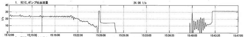

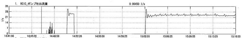

In summary: RCIC consists of a series of pumps, valves, and manifolds that allow coolant to be circulated around the reactor pressure vessel in the event of a loss of the main feedwater supply.In summary, the earthquake and tsunami may have caused a loss of coolant at the Fukushima Daiichi NPP, which could lead to a meltdown. The system for cooling the reactor core is designed to kick in in the event of a loss of feedwater, and fortunately this appears not to have happened yet.

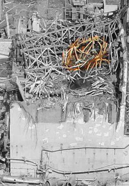

Jorge Stolfi said:
My comments were based on the right half of this image from a previous post, allegedly a photo taken after the earthquake (and tsunami?) but before the #4 explosion:
[PLAIN]http://www.ic.unicamp.br/~stolfi/EXPORT/projects/fukushima/povray/blueprint/foto/edited/src/reactor4-S-7.png
In this photo the staircase seem to be still there, whereas the Mysterious Green Box has been replaced by the Mysterious Hole With Mickey Mouse Ears.
Note that the "Dark Goo Flowing Down From The Terrace" is already there.
