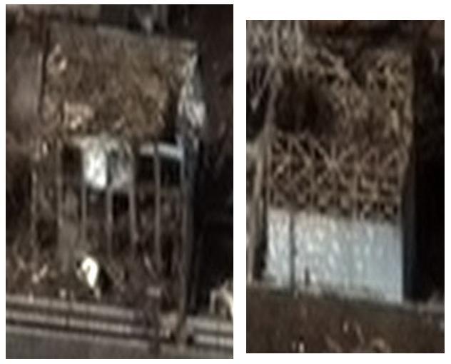

Did you remark by the way (i'm sure some did already :approve:) that a huge chunk of concrete from probably N°3 reactor landed right on the two long parallel tubings just at the level of N°4 reactor? This is a huge piece and i wonder from where it could come fron N°2 reactor (see the thickness of this!):
http://www.netimago.com/image_200794.html
On this view, based on some known distance (the distance between the pillars of N04 reactor for example), this chunk is around 7-8 meters wide and 4 meters thick...
http://www.netimago.com/image_200796.html
On this view, based on some known distance (the distance between the pillars of N04 reactor for example), this chunk is around 7-8 by 6-7 meters big...
The shape is very intiguing also...
Too thick to come from a regular wall, so maybe a piece of a floor or... a piece of containment?
I'm wondering if this is not one of the big chunk that we see falling down on the right side of plume during N°3 reactor explosion.
EDIT I correct immediately what i just said about this huge piece of concrete. It's not coming from N°3 explosion, as this piece doesn't appear at this place on satellite view after this explosion:
http://www.netimago.com/image_200872.html
This huge piece comes probably from N°4 "1st floor visible" (actually it is i think second floor) broken wall.
Look at this picture:
http://www.netimago.com/image_200874.html
The hole just behind the big chunk on the rightmost side of the wall is IMHO where it comes from.
Looking at how thick this piece of concrete is, we can imagine the force of the explosion at this place to break such a piece in a place which seems a little far from the attic SFPs where H2 "could" have originated (the only place in fact where there was fuel). Did the explosion at N°4 originated in the lowest floors in this area? The only place where the roof has disappeared is above this place and the north wall is heavily dislocated.

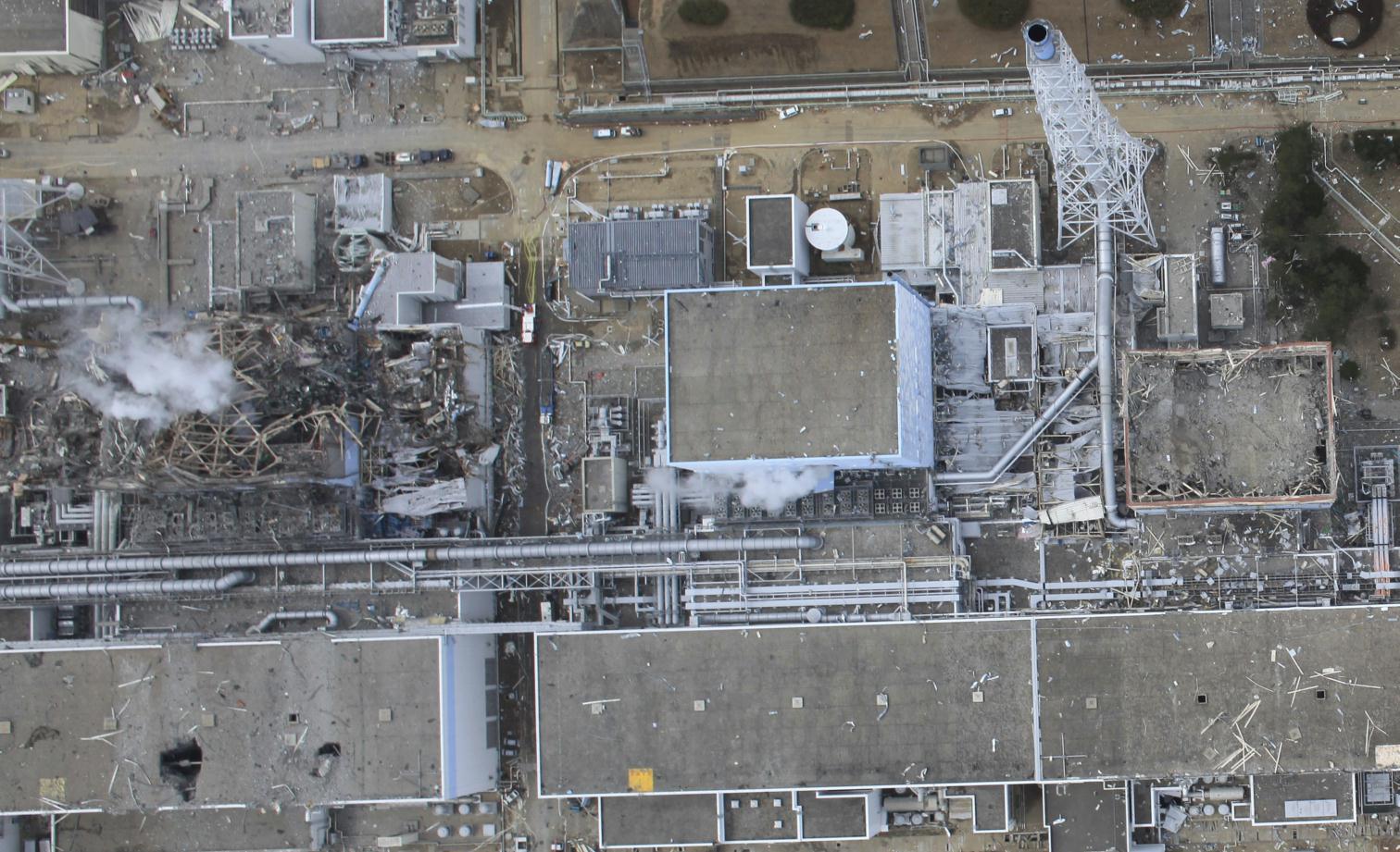

(off topic)
This helicopterfootage shows (at 5:30) some piping next to reactor 4 that has been ruptured and seems to be coming from the exhaust stack between units 3 and 4
There's some strange yellowish material that is laying on the pipe.
Looking at the posted high resolution arial photo of this area I notice a ' streak ' of yellow material that seems to point towards the big hole on top of the turbine building next to unit 3
http://img716.imageshack.us/img716/8693/reactor4piping2.jpg
And then I notice the shape of the hole compared to the yellow cap visible in unit 4 :
(Highly speculative ...)
Could this hole in the roof have been formed by the yellow reactorcap from unit3 ?
And the yellow streak be scattered debris from the impact ?
What else here is yellow ( not yellowcake I presume ?)Not that I expect a confirmation of course , I don't know if TEPCO has even been able to investigate that part.
http://img96.imageshack.us/img96/561/aerial201133002011yello.jpg

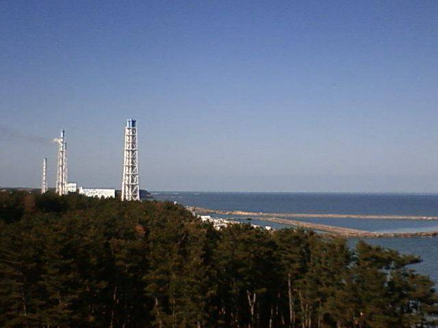

jlduh said:
Where did you get this picture? When was it taken? Are you sure it was there (the scaffold builder) when the explosion occurred? I don't see it on the pictures...
I found that old picture from Reuters here:
http://hken.ibtimes.com/articles/124108/20110318/fukushima-daiichi-nuclear-power-plant-risks-at-each-reactor-japan-stricken-plant.htm
It is from 2008, so their work should be done.
Very good observations from you, but my english ist too limited to discuss in this professional circle. Let me say just thanks to all contributors of this excellent thread!
Ok, thanks, if it's 2008 the work should be finished, yes :smile: I was thinking of a recent picture just before the accident...

GJBRKS said:
This helicopterfootage shows (at 5:30) some piping next to reactor 4 that has been ruptured and seems to be coming from the exhaust stack between units 3 and 4.
I don't think, it is ruptured. Just a matter of perspective:

GJBRKS said:
(off topic)
Going further off topic. Rock wool is yellow. It is found in roofs, for purposes of insulation.
I cannot imagine a kind of explosion that would smash that cap into tiny little pieces. Not even a nuke could do that, the cap would vaporize first.
Small explosions might rock it a bit off its seat or maybe bust a hole clean through if there was something small and heavy inside that got propelled real fast by a high speed blast (another thing I don't believe in, because the horrible amount of damage suggests low speed, long pulse, plenty of time for concrete to realize what's happening and start to crack).
Big explosions could make it fly off as a whole or maybe (maybe!) crack at a seam and open up like a can of sardines, IF it has any seams, IF it was too well anchored.
I do not believe in many small chunks of high-grade steel, all of them falling painted side up and not scorched/blackened by soot in the aftermath of the explosion that made them part company.
I think perhaps this chunk might be from the top level of panels. From the low position it would seem a big ventilator thing have miraculously escaped the collision. Against this thought speaks the apparent low grade damage to the pipe on which the chunk fell.
The more I look at unit 4, the more an impression forms of a building thoroughly filled with a mixture of hydrogen and air enough to cause a widespread deflagration, if not an explosion.
I've attached a frame from the THawk trip along the turbine buildings showing the chunk.

Find attached photos from two angles of a cylindrical oject lying leaned to the roof wall of turbine building 3. Seen from the THawk angle, one can well interpret the object as being connected to the piping there, i.e part of the original installation, albeit somewhat damaged. However, seen from the west in a zoom from one of the herostratic high resolution photos, it can be seen that it is not mounted, but has crashed on top of the original pipe. It has not been possible for me to find any satellite photo from before the unit3 explosion showing this object. So, I am led to believe that this object could be one of the ballistic objects. I have no idea what it could be, and where it sat in the building before the explosion. No high hopes that anybody can identify it, there are few clues except shape and a peculiar coat it appears to have been lined with.
