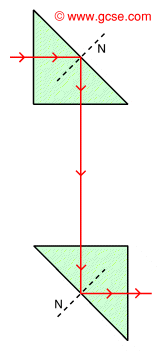

My textbook says that for total internal reflection to occur 2 conditions need to be met. Light is traveling more slowly in the first medium than the second medium and no.2 is the angle of incidence must be large enough for no refraction to occur.
My question is about the first condition why does total internal reflection occur when a light ray is shined through a Glass Isoceles Right Angle Prism like the one in old submarine periscopes. I mean isn't light traveling from air to glass therefore entering from a less dense medium into a more dense medium meaning light is faster in the first medium than the second medium. I don't understand it
I need a good answer please and I am in Grade 10 so don't make it very complex
Heres the link of the prism I am alking about: http://www.gcse.com/waves/images/periscope.gif
Also Sources would be appreciated. Thank You very much

The first condition is backwards- total internal reflection can occur when light travels from a more dense to a less dense medium (e.g. glass to air, or water to air), and 'density' refers to the index of refraction: a more dense medium has a higher index.
Does this help?
Sounds right to me.
Sure, light travels from air to glass, but that's not where the total internal reflection is taking place. The total internal reflection takes place where the light is going from glass to air (or trying to, at least). (Just as Andy Resnick explained.)
I think you just misinterpreted your textbook a bit. In your example, the 'first medium' would be the glass, not the air. (I hope the text went on to explain things a bit more clearly.)
