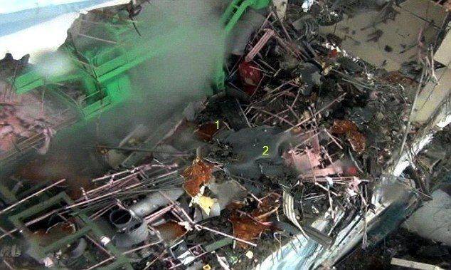

AntonL said:
That seems to be correct, steam coming from the transfer chute area, what are the implication for the containment - TCups that drawing of yours with orange flame marks seems very plausible.
As for the condition of the fuel in SFP with heavy stuff dropping in we can only speculate, An explosive shockwave followed by a crane falling into the pool, could that have "Tsunamied" a bundle of fuel rods out of the pool, that we speculated to have observed in other photos?
Below image of crane in block 4 for comparison, seems to gone missing in block 3
and for block 1 we can see in the video the roof wrapped around the crane
I believe the image is from - http://www.youtube.com/modchannel/?gl=JP&hl=ja
11-03-27 (March 27, 2011) 10:11:06 (video 2:32 / 4:21)
It seems similar to the screen shot I took.
I expect that the refueling or fuel handling machine is parked over or at the end of the spent fuel pool.
There is another shot of a yellow cap, which is probably the drywell head/cap of unit 4.
I would expect that the dry well cap is on the opposite end of the building from the spent fuel pool.

@Astronuc -
Yes. Just so we are on the same page --
The drywell cap and fuel handling machine in the screen shots you referenced are from unit 4, where,
1) the explosion appeared less intense than in unit 3, and
2) the fuel rods had been taken out of the reactor core 4 and put in the SFP 4
3) the fuel handling machine from unit 4 has been visible on all previous videos, I believe.
The annotated photo with the proposed location of the fuel handling machine actually in the SFP is from unit 3. The suggestion that the fuel handling machine is actually in the pool came from the reference in the initial post #1760
https://www.physicsforums.com/showpost.php?p=3215310&postcount=1760
To Recap
The venting steam is coming (or initially came) from unit 3, in an area where I suggest there may have been damage to the chute and gate forming part of the primary containment for RV3. I postulate that had the water level in SFP 3 been low, then there would have been no water behind the gate and that the loss of hydrostatic pressure behind the gate, plus possible compromise of the pneumatic seals of the gate, plus one hell of an explosion, may have damaged the primary containment at the location of the gate, whether the hydrogen explosion originated from within the drywall containment or from the top floor of the building.
The reinforced concrete weight bearing columns, east and west, coupled to the large rails for the overhead crane tended to hold the sidewalls together, such that the main force of the explosion (actually in both units 3 and 4) seem to have blown out the north-south walls and the roof.
In unit 3, the north wall weight bearing columns actually collapsed and the overhead crane ended up atop an adjacent building below on the north side of bldg 3.
