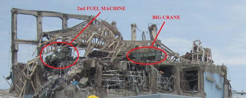

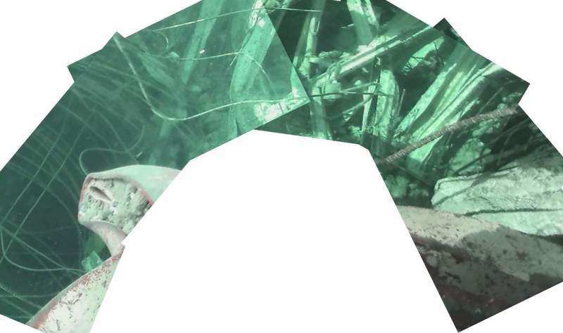

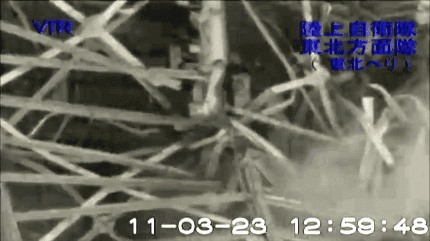

Rive said:
<..>Some pictures attached. The THawk.jpg is from the first THawk-releases, the other two is from the drone flyovers at 03.24. Any ideas?
I remember first time I looked into the green eye of Mount Unit3 and felt at the same time attracted to and abhorred by it. It was an alien, unearthly experience.
It is not easy to get a good view of what is down there. It would seem to me indicated that this part of the service floor after having being initially razed by an outward/upwards blast, suffered a final hit by a substantial amount of roof material coming down from above. Following that, I'd expect if one could dig into the eye aka the sfp3, the first solid material one would encounter would be roof material that has fallen into it and on top of what else was in there. It would follow, that I should think there is water in the pool.
Unfortunately the fallen roof debris makes it very hard to see what equipment might have sticked around the pool at its edges, at the level of the service floor.
There does appear to me some wreckage squeezed up at the southeast corner of the pool at about that level. To the southwest, we see the remains of the 'little building' from which one could once look down on the pool. To the west we may see a short section of uncovered edge of pool. To the north it's a bungled mess of tormented roof structure, there is no visual of where the edge of the pool is. One could probably assess where it is by working from an estimate of the position and size of the interfacing reactor opening.
One more thought. looking for fhm3, one would tend to look for something green, but looking in this portion of the roof, for such parts that have remained here there's the possibility that such parts might have become more rusty than green due to influence of heat and moisture.
And a caveat. There are videos as well as frames in circulation that appear to be showing a pattern of finely drawn greenish fuel racks in the sfp3, but I have had occasion to check those up against less reprocessed video material of same origin, which do not show any such pattern, so I think they must be artefacts of compression and recompression.

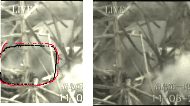

So, at least I am seeing something.
Ok. It is a pincushion efect OR the camera is tilted. To me, pincushion seems a better explanation, as the intact-looking building seems to be straight. I can't see the left-most tower well enough to decide if it looks tilted as well (which would confirm pincushion).
I'll try to come up with a way to verify. Later, all.

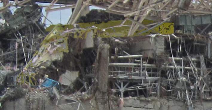

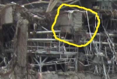

triumph61 said:
A lot of yellow "things" are seen on pictures. I have marked them. Please zoom and scroll.
Yellow is an unusual color in this imagery, and yellow might spell containment cap, however I'd expect that to a piece that is not likely to have shattered to pieces. Looking for a large yellow object , the eye easily conflates two separate lesser yellowish objects to give the appearance of the presence of one larger object camouflaged by debris. There is a suggestive visual in this photo of something big and yellow in the building in front of unit 3, but the sight from other angles of this spot is disappointing and quite confusing. My intuition is that some longish object has slid into the opening, and the yellow sighting is due to conflation (see attachment with closeup from another angle)
Up on the building, one column in from the collapsed corner,behind a pillar half sunk into the servicefloor, there is in many visuals a strong appearance of a large object, but its yellowishness in some visuals is due to conflation of other lesser yellow objects on top of the pile. There may still be some large object there, but I am pretty sure it is not the containment cap. I find it curious that I cannot seem to get a handle on what it might then be (if it is anything but an illusion). We have actually pretty good images of that corner (see attachment)

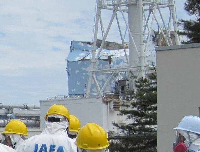

From the viewpoint of this photo one can see right through the building, through a blown out wall panel at the 4th floor west, to one of the blown out panels east above the sfp. So, in its present state, the service floor of unit 4 is not intact at the west edge of the pool.
http://www.houseoffoust.com/fukushima/tv/vid9.jpg
Both U3 and U4 has a hole on the service floor at that position for moving the fuel casks. FOr normal operation it's covered, but after the explosion... So it's not necessarily a structural damage.
Ps.: I could find nothing useful for this in the other videos (T-Hawk).
  • #5,862
Top beam = roof level
followed by Crane girder beam
followed by top floor or service floor
view is as expected when wall panels are removed

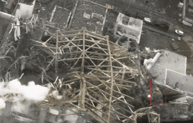

OK, I see that now, thanks AnthonL, Rive. Through that 'by design' hole in the servicefloor, I would be looking up through the far end of the roof, I reckon.
Attached in another crack in a floor, I hope I am more lucky with that one :-)
See attachment, left frame:
Looking down from the west on unit 3 on a sunny day, there is an unusual bright speck visible, looking though the fuel transfer hole, apparently a speck of sunlight inside the building at 4th floor, next to the SFP.
Alternatively the speck of light could be formed by something closer up to the fuel transfer hole, something hanging out in the air within its frame and being lit by sunlight falling through the transfer hole.
However, in that case the speck of light should be also visible in the photo from the same occasion, that is looking straight down in the hole, and it is not, see attachment right frame.
So I am left with my immediate impression that sunlight must coming in through a crack in the servicefloor. I can't think of any other explanation.
Sunlight is coming in from the SSE, so the crack would seem to be somewhere about the area of the floor I have encircled in the right frame.
(That there is a crack in the servicefloor of unit 3 may not be exactly breaking news, but personally I had sort of ticked this particular part of the concrete deck as 'likely undamaged'.)

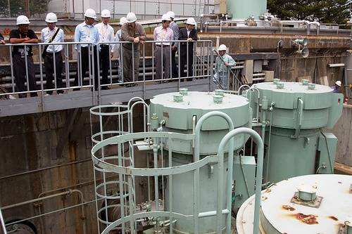

There is something shiny on the 'tour' video, but I will not say that they are the same.

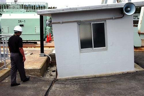

SteveElbows said:
Its approximately the right size, and its in a place that would make sense.
However, looking at an image taken from a different angle clearly shows that its actually some sort of ground vehicle/crane that has an arm extending into the sky (the small one near bottom of this picture, not the larger more obvious crane):
Ah, yes, I should have looked at other pictures from different angles before posting. Attached is again the overhead view but including the unit 3 reactor building as well. (A) is what I thought could be the FHM, but on the other picture one can see that it is clearly a crane (You also had that view attached, which I just saw now, because last time I checked I was not logged in and therefore could not view it).
I also had some comments on the deformed roof girders (C) (yellow, rusty) and the other deformed objects (B) (gray), and had written a response earlier but then I got timed out before sending it... argh. Anyway, I agree that (B) must be some kind of panels from the roof (aluminum?), as such objects can be seen also on the much more intact roof of unit4. While I first thought their spaghetti-like deformation might be due to heating, I now tend to think that these panels are probably thin and can easily be deformed simply by the forces during the explosion. The steel roof girders (C) also seemed deformed due to melting to me around where the reactor should be. But that could in principle also be due to the forces during the explosion, not necessarily due to the heat. Concerning the rust on them, I think it makes sense that that comes from the steam from the reactor. The third attached picture shows that the rusty areas coincide more or less with where the steam from the reactor poured out. (All three images are taken from the houseoffoust site.)
A slightly unrelated question: Why are the SFPs in these kind of reactor designs not at least covered with a concrete block like the reactor is during normal operation (that might not have helped at unit4...) ? It almost seems like the SFP was some kind of afterthought in the containment design.

Although I have been following this thread for a while, I have one question which I haven't seen addressed yet, although it might already have been discussed somewhere in the 5000+ posts. Sorry, if that is the case.
As far as I understand, in unit 1 the wall panels from the service floor upward are designed as blowout panels, i.e. they are meant to blow out easily in case of a hydrogen explosion on the service floor. That the explosion at unit 1 went relatively graceful thanks to these panels can be seen from the fact that the wall steel structure is basically still standing. Unit 2 also seems to have blowout panels, as the whole in the wall looks rather clean (see first attached picture).
At unit 3&4 however, they apparently changed the construction of the walls above the service floor, and used reinforced concrete pillars instead of the steel structure and reinforced concrete "panels" in between (see second attached picture of unit 4). Now, I am wondering if those were still supposed to have the function of "blowout panels", or if they just thought "oh, let's make those upper walls a bit more sturdy" without taking into account that a hydrogen explosion on the service floor will be much more devastating, as there is no easy way out any more. Indeed the explosion at unit three was much worse than at unit 1, destroying the walls completely on three sides of the building, and even kicking out concrete panels below the service floor. In addition, the stuff flying around was much heavier and caused more damage than in case of unit 1.
So, my question is basically if the upper walls in unit 3 had been the same as in unit 1, would the damage have been less severe? And are those reinforced concrete panels a Japanese "upgrade", which turned out to actually make things worse? Do other reactors of this type built e.g. in the US still have blow out panels like unit 1 (From the cut out drawings from GE it looks like both Mark I and Mark II containments have blowout-able upper wall structures).
[Both images taken from houseoffoust]
