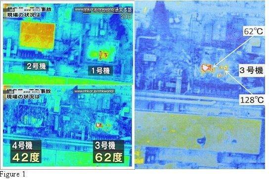

Yes but they've been pulled from you tube so thought I would re-post! your obs. are interesting, that whisky thing could be the top of reactor vessel, and yes... no idea what the brown stuff is but don't know what those pipes were carrying before, steam probably as they run to the chimney stacks. there's a lot of info in these vids so I'm surprised no 'experts' have analysed them.
THERMAL IMAGE OF REACTORS for those interested there's a discussion on housepricecrashforum, where one poster has posted this recent thermal image:
http://www.zerohedge.com/sites/default/files/images/user5/imageroot/bernanke/heatAll.jpg
This is a very interesting science/engineering problem and the lack of information is just so frustrating.
