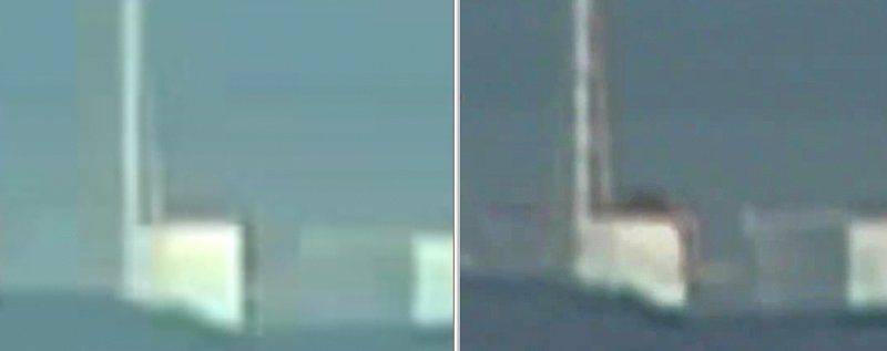

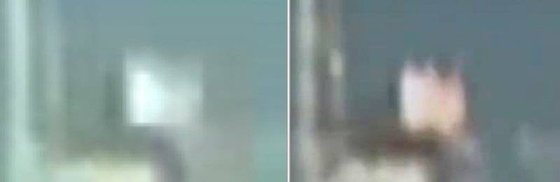

Samy24 said:
What should this "light" proof? The explosion was at daylight.
It should be a proof for neutron radiation.
Accordingly, there had been partial criticality.
The image was sharpened and subsequently processed..
http://www.sueddeutsche.de/wissen/japan-nachbeben-der-staerke--1.1075927
A german newspaper. A good one. I translate with the google translator:
The operating company Tepco said on Wednesday that it had in 1.5 kilometers away from the reactor neutron beams measured a total of 13 times on the site, indicating a withdrawal of the radioactive material
http://en.wikipedia.org/wiki/Neutron_radiation#Sources
Neutrons may be emitted from nuclear fusion or nuclear fission, or from any number of different nuclear reactions such as from radioactive decay or reactions from particle interactions (such as from cosmic rays or particle accelerators). Large neutron sources are rare, and are usually limited to large-sized devices like nuclear reactors or particle accelerators (such as the Spallation Neutron Source).
So we still have high temperatures in the reactors.
The neutron beams were visible until Tuesday of this week.
i wrote it with the google translator.
Sorry
