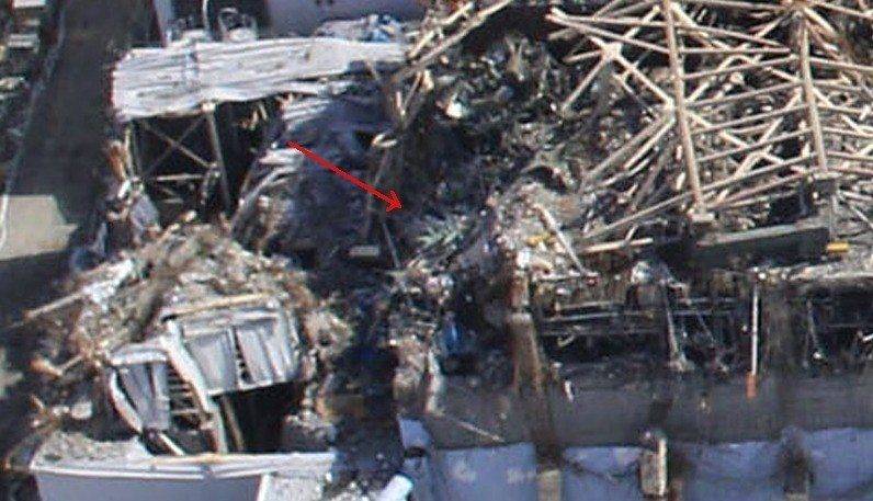

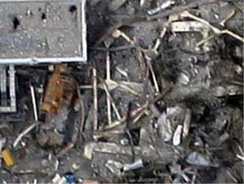

Image from TEPCO of concrete pump used to take pictures of unit 4 reactor service floor and SFP
http://www.tepco.co.jp/en/news/110311/images/110412_1f_4.JPG
Yellow containment cap in Unit 4.
http://www.tepco.co.jp/en/news/110311/images/110415_1f_3_8.jpg
I suspect what was cited as spent fuel rods outside of containment is actually rebar blown out of the walls (image of south face of unit 4).
http://www.tepco.co.jp/en/news/110311/images/110415_1f_3_5.jpg
I can't find the source (other than TEPCO) for the attached images, but they show the sampling vessel and top view of Unit 4 SFP. The water is turbid - maybe from boric acid or from suspended fission products and/or corrosion products.
Update: Source of images - http://www.tepco.co.jp/en/news/110311/
