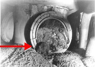

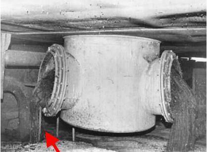

Ooohh ! I like it how they translated 'flange' mucho - mas ! ! :)
AntonL said:
Nice images of temperature graphs and temperature sensor locations
[PLAIN]http://k.min.us/in4JQ0.JPG
