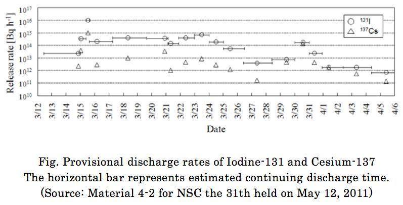

Large amount of cladding failures, yes. But concerning the max temperature of the core, information regarding the quantities of elements that evaporate between 1000 and 1500 degrees Celsius would be really important. It would help to see the results (besides the easily-evaporating I and Cs nuclides) of the analyses of the water found at different locations at the plant buildings (or even better, the raw gamma spectra) in order to see what has come out and how much.
Soil and air samples found at the site can be largely explained by the explosion at unit 3 service floor and don't thus tell much about the condition of the cores.

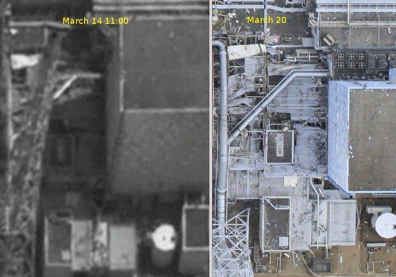

Find attached my assessment of the state of the roof structure of unit 3, after the explosion.
Based on visual inspection of photos, each field in a 16x24 matrix covering the entire roof structure was assessed to one of five categories of damage, see legend. The method used gives the assessment a resolution of about 1.5 meter.
Fragments found on the roof of unit 3 were assessed, as were fragments of the roof structure locatable to the south and the east side of the building. Due to poor photo coverage and their inter-mixture with other debris fragments which ended to the north of the building could not be inspected. Those parts of the structure from the N end and from the SE corner which could not be inspected were assessed based on plausibility, judging from visually inspected close-by or bordering fields.
Excellent! Now, add the overlay of the floor plan of the top floor. BTW, you should be marking this kind of work "copyright, 2011" and put your name on it, MadderDoc. There may be a publication in your future.
  • #6,831
|Fred said:
I've overlay and added some labeled
I do believe that we can see an original steel structure between A and B
Nice job, |Fred. That conclusion about A and B is tempting, seeing there _is_ apparently a traverse in what appears to be the original position.
From a plausibility viewpoint one could say, why should it be in the orginal position considering the utter damage around it. However, more to the evidential, the interpretation leaves another structure unexplained, which I have marked in blue here:
I believe what is marked in light blue there is in fact the sorry remains of the original steel traverse between A and B.
In that interpretation the traverse that gives the illusion of being the original AB-traverse, is a loose traverse from uphill the roof structure further east, which has come to rest in this position - not quite incidentally, seeing that the trusses at both point A and B are kinked downwards, producing the nearest low resting position for it to come to rest in after having come loose. The high resolution photos looking in from the west also indicates that the traverse we see between A and B, may actually not be affixed to point A, but rather is resting close to and on top of it.

thx MadderDoc, I don't have time to finish that now.. but I'm in the process of doing this
[PLAIN]http://i.min.us/jlgANw.jpg
grr.. i got one color wrong.. on the right picture "the reconstructed thing..
