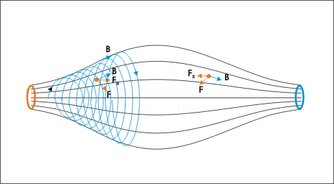

I'm beginning to think my confusion arises out of a possible mistake from my professor. He claimed that the magnetic dipole moment vector tends to line up with the magnetic field vector and that the magnetic field of the dipole moment enforces the exterior magnetic field. Is this last remark true? If the opposite is true: that when it is aligned, the magnetic field arising from the magnetic dipole works AGAINST the exterior magnetic field, then that solves my confusion...
One more remark though: if the magnetic dipole moment vector of "something" always tends to align with the exterior magnetic field, then why does it not in the following example:
A magnetic bottle.
You can associate a magnetic dipole moment with the proton, which is a vector pointing to the left. This is clearly not pointing to the right, as does the magnetic field...

Aha, I see what you're saying. But I still believe my professor made a mistake. As you say, the magnetic dipole aligns with the external B field and enforces the magnetic field inside the dipole and diminishes B outside the dipole. He claimed the opposite (unless I noted it wrongly...) His claim was that electric and magnetic dipoles are fundamentally different in the way that the former diminishes the external field and the latter enforces the external field. But that's wrong, then, isn't it? They BOTH work against the external field, with the only exception that the magnetic dipole enforces the magnetic field INSIDE (but I don't think he was talking about that, because if you were to replace the current-magnetic dipole with a small magnet, you wouldn't be able to see what happens inside the magnet and it would be enough the say the magnet aligns and just does nothing but decrease the field [except for a bit at both ends...]).
Thanks for your little explenation about the origin of it all. The alignment of dipoles then makes a lot of sense, cause otherwise there pretty much couldn't exist any big material magnets.
One further question though, as I noted in my 2nd post: you can view the proton as having a magnetic dipole (just like a current or the electrons in the classical model), but the weird thing is: in the magnetic bottle, the magnetic dipole vector is 180° opposite to the external field, while it should have a much lower potential energy if it was aligned like you'd expect a magnetic dipole to do. (I understand it's weird to imagine it actually flipping, but technically speaking, if you handle the proton as nothing but a magnetic dipole, you seem to have a very odd situation that's contradictory to "the magnetic dipole tends to align with the external field" -- is it maybe just in an unstable equilibrium?)
