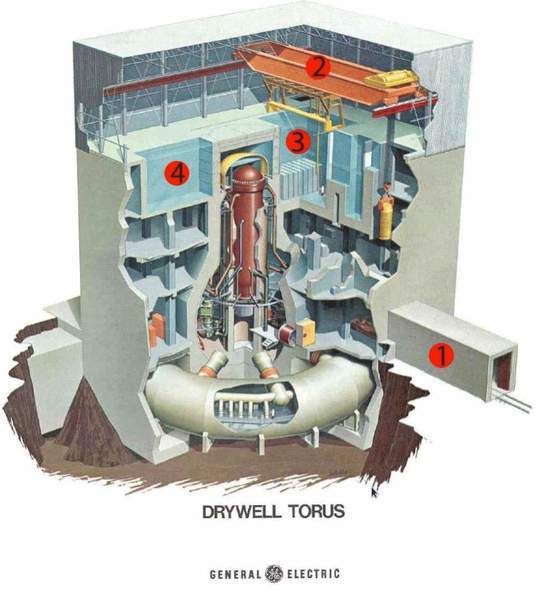

OK, Oyester Creek, but then I have to assume that the most identifiable feature in the Fukushima building after the blast -- the intact square hole where the fuel casks are lifted by the crane, has been cut away from this drawing, correct?
Also, a small portion of the gate connecting the primary containment to the SFP is shown near the bottom of the transfer channel or "chute". If the scale is correct, it greatly reinforces my contention that the path of least resistance of a blast originating in the primary containment, outside of the RV would be through that gate (even if there are 2 of them, which does not appear to be the case) rather than out the top of the plug.
Notice the design. It appears to me that the logic behind a relatively thin-walled (concrete+ steel, or steel?) gate is that there is a large volume of water behind it, which under normal conditions, would tend to greatly reinforce the backside pressure on the gate at that point. If so, then here is another major design flaw. The reactor containment is compromised if the spent fuel pool is more than a few feet low on coolant. I suspect that the original designers considered an empty SFP with a hot reactor an unthinkable event. If so, then they should re-think that one.
Also, it occurs to me that if the overhead crane were parked at the north end of the building, it's weight would tend to bend the north end wall inward if the south, east and west walls were blown out, accounting for the under-folded north wall girders in our current pictures of Unit 3.
My conclusion:
Loss of water in the SFP greatly compromised the integrity of the reactor containment and the containment of the rods in the SFP when hydrogen and oxygen gasses in the reactor containment exploded. The dark smoke in the latest news release is ominous. I now fear that they may now have lost both the reactor core and the primary containment.
Someone please refute that.
The SFP has no significant structural association (to my knowledge) with the reactor's primary containment and surely not the Reactor Vessel that would lead to such a speculation.
Some causation thoughts: Due to the heavy seismic activity the primary containment (concrete) may have been compromised by sheared pipe lines and pneumatic seals on the top of the primary containment. The SFP is an independent system (piping and construction) as you can see from the drawings. Even with the access gates open it does not have to be further flooded to protect the spent fuel. Flooding the primary containment with sea water to externally cool the reactor vessel and its contents will definitely lead to a big and smelly mess within the primary containment. It is not known whether or not the reactor vessel has experienced a large break LOCA, but something has caused the reactor vessel water level to decrease and is surely the effects of trying to control RPV pressure via venting to the Primary Containment with no make up water to the RPV. The station is in a "black out" situation (no electrical power) that effectively stops all but the manual operation of valves (if they are so equipped). I believe venting of the RPV to the Primary Containment is automatically initiated on over pressurization, akin to your home water heater, but a little more complicated. Steam from venting would normally condense in the Suppression Pool and be pumped back to the RPV (alas no power for the pumps). Venting of accumalated gaes from the Primary Containment is by seepage or open valves (or blast damaged piping and valves), since the Stand-bye and normal off-gas system pumps are basically isolated or shutdown. I noted that TEPCO decided to cut holes in some of the reactor buildings to prevent buildup of explosive gases, which indicates to me they have very little control over the venting of the Primary Containments and the avenue of releases. Reactor relief valves have a limit on their ability to reset and contain pressures due to continued recycling, high temperature water and steam flows affecting their valve seats and springs. Sticking relief valves is not new stuff to the industry.
I do not understand why they have not established a continuous and remotely operated fogging spray over the reator buildings emitting steam and smoke to reduce the plume effects of offsite releases.
Just some idle thoughts. Won't know the whole story until events, actions and results sifted through, and are published in the future.

If the fuel transfer chute and gate (yellow) were the weak spot. A blow out here would cause a blast from inside the primary containment to blow out and up from the south end of the building, blow out the roof over the south end, and if the heavy crane (blue) partially shielded the north wall, perhaps collapse it inward with portions of the roof girders over it. Venting stem would come from the region of the chute.
