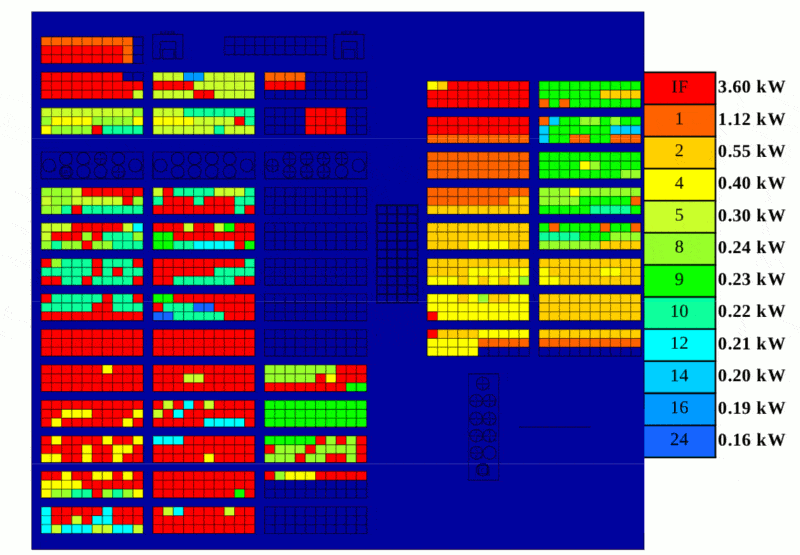

Some NPPs has separate pools to receive fuel casks. These pools are connected with the main pool by channels, as it can be seen on the general BWR GE MK1 drawing. I've checked this SFP-covering thing through my NPP-pictures collection, and these additional pools looks missing on some pictures, even if that NPP has such pools.
Of course it's possible that I made some mistakes during collecting the pictures, but maybe it worth to consider if these covers belongs to the additional pools.

I have not seen any covered spent fuel pools in the plants I have visited, toured, or worked at. Nor have I found reguatory mentions of covered pools in US or International websites. There may be such pools, I just found nothing definitive, so I tried to think of reasons why covering a pool might be problematic - thus my list in the previous post.
The OP pdObq was asking a question that he had apparently asked before without response. I think he assumed a cover might have protected the fuel in the pools at Fukushimafrom the debris from the explosions. It is a legitimate question that deserves an answer. I'm hoping my post may trigger some discussion about whether covering fuel pools would be a good idea based on what happened at Fukushima.
