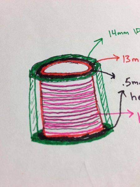

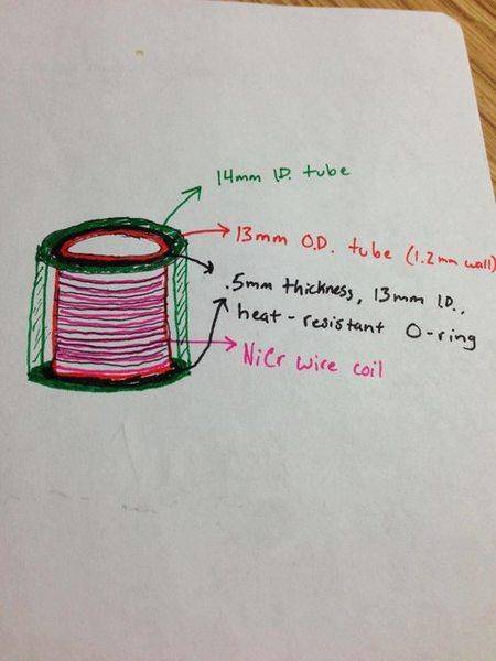

I found a Pyrex tube that has a 13mm OD and 1.2mm walls. I read that Pyrex has a low coefficient of thermal expansion, and especially when its only to ~400°F, I would think it wouldn't be an issue to wrap the NiCr wire around it.
And would it be alright to just wind the NiCr wire around the glass tube and hope that the wire would slide down and touch itself? What are the consequences of two loops touching each other?
Here's a pretty crude drawing I made of the heating element. Starting with a 13mm OD tube, you wrap that with the NiCr wire coil. Then you put a silicone heat resistant O-ring around each end of it, and fit it inside of a 14mm ID tube so you have a nice seal and the wire won't be touching anything directly except for the silicone O-ring which should stand the heat.
Unless it would be an issue to have this air sealed in there... If this made a good seal and was heated to 400°F, would the air expand and make it explode? Just thinkin' out loud here.
