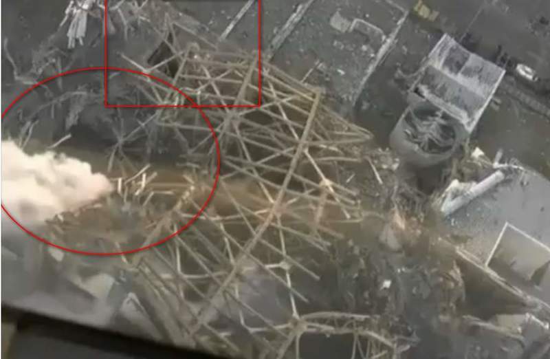

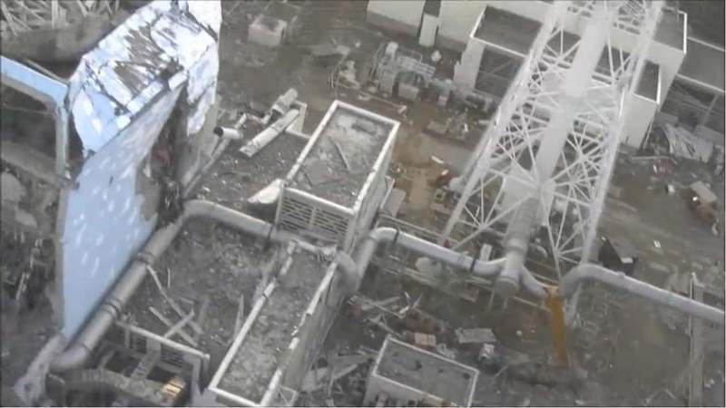

To all,
What degree of confidence could a plant operator or engineer put on identification of a blurred white dot appearing for a couple of seconds in a helicopter flyby as being an adequate level of water in an SPF?
With that helicopter pilot risking and more than likely shortening his life, I have one question, WHERE ARE OUR PREDATOR UNMANNED DRONES WITH THEIR HIGH RESOLUTION 3 MILLION DOLLAR CAMERA'S. This is a no-brainer, at least for me, if ever they needed the technology, it was YESTERDAY ! There I feel better, having vented. Back to normal. Just had to vent, sorry.
Rhody...:redface: :confused: :rolleyes:

rhody said:
To all,
I don't think he was in any great danger (especially from radiation) other than that is normally associated with flying an apparatus that drops like a boiled egg when the rotors stop. You didn't see him flying directly over the units or through a steam cloud did you?
