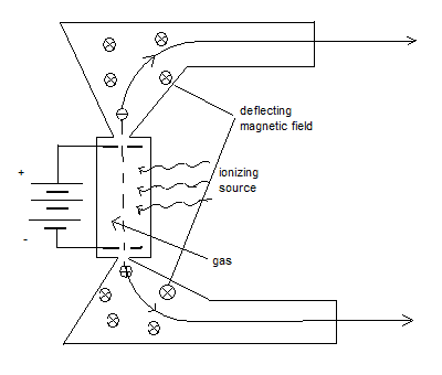

How about something like this device
Naty1 said:
Sounds like you mean using electrons directly for propulsion?? good idea. as far as it goes...
You can use electrons, or positively charged ions, for propulsion of a spacecraft , but as soon as the spacecraft builds up a residual charge of a few microCoulombs, the electrons or ions will be attracted back to the spacecraft and the propulsion will cease.
A typical spacecraft will have a self-capacitance of ~100 to 1000 picoFarads, so a charge buildup of a few microCoulombs will be significant. Dickfore's solution will work, because it accelerates an equal # of electrons and ions.
[added] See electron injection ion neutralizer in
http://en.wikipedia.org/wiki/File:Ion_engine.svg
Bob S
Bob S said:
...propulsion will cease.
Exactly. That's the problem.
Regardless of method, mass must be expelled.
Additional propulsive mass must be made available.
