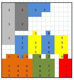

Here is a solution with 254 tiles:
Consider a 2x2-block
a b
c d
It contains every combination of those 4 digits without repetition, 24 numbers in total.
To get all 720 numbers with 3 different digits, we need at least 30 sets of those 4 numbers.
I started with all sets containing 1, and found a solution for 12 of those sets:
1234

Obviously, they have some overlap: Groups which share two numbers. This allows a better packing into 3 blocks of 9 tiles each:
8 5 6
0 1 2
6 3 4
3 7 8
5 1 2
4 9 0
6 9 3
7 1 8
0 4 6
Every possible "L"-shaped set in those blocks gives 6 unique, different numbers, with a total of 12*24=288 numbers in those 27 tiles, including 216 with a 1 inside.

Before you give that to your friend, you should let a computer check all combinations ;).Edit4: In any way, it fits in a 16x16-square without problems, see attachment. Even if there are some numbers missing, it is easy to add them.
You can combine 1/2/3/8/9 to save even more space without problems. This allows a reduction of at least 16 tiles. In addition, I would expect that many elements of the upper "3"-part are included in other elements, so this could shrink a bit, too.

For now I just settled with a program to randomly populate a 16x16 table with the digits. The program also checks if all numbers from 000 to 999 exist in the table; if not, it generates another table.
Thanks again!
I would be interested in the fraction of tables with all numbers present.
We have ~10000 possible combinations, if they are all independent this leads to a probability of ~5% that at least one number is missing. Correlations increase this fraction a bit, but probably not more than a factor of 2. Hmm, ok, random tables are good.
