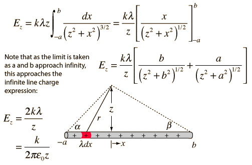

4. The electric field will be inversely proportional to radius squared?
No, it's inversely proportional to radius. You can look up the solution or derive it if you don't believe me.
What planet are you from? I don't think you should be allowed to make any more statements without providing some source to back it up. There is nothing to derive, it is experimentally established relation and the 1st chapter in electromagnetism on this planet, it's called Coulomb's law:
[tex]E = {1 \over 4\pi\varepsilon_0}\frac{q}{r^2}[/tex]
http://en.wikipedia.org/wiki/Coulomb's_lawNow, can you provide some reference for this nonsense: [tex]E_r={{q}\over{2\pi \epsilon r}}[/tex]

Dunnis said:
Look it up where, in your dreams?
The radial electric field strength of a coaxial cable operating in the fundamental mode has 1/r dependence. Note this is about alternating currents.
In the limt of DC current, it is also 1/r dependent, but the radial component is zero valued; 0*(1/r)=0.
The currents in different phases along the length of the cable are not equal. Charge continuity requires that the charge be not always zero valued. It is not much different than a wave guide, where there are oscillations in all of B, E, phi and J.
