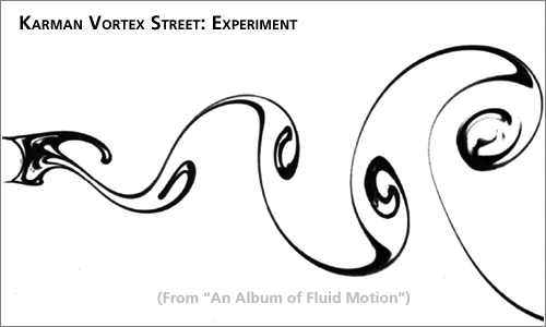

So now what? Now we introduce the idea of vorticity and circulation. Consider the flow of an inviscid incompressible fluid past a body started from rest by conservative forces. The motion is not unique, unless the flow is continuous. If the flow is continuous, the Helmholtz-Kelvin theorem states that the velocity is the gradient of a single-valued potential. If discontinuous flow is allowed, by for example allowing the creation of a vortex sheet from separated flow, the unsteady flow no longer has a unique solution.
This has the best images I could find right now:
http://www.biketechreview.com/aerodynamics/misc/466-skinsuits-and-boundary-layers?start=2
Vortices have 'circulation' associated with them, and so again, by the Helmholtz-Kelvin theorem (circulation is conserved), there is circulation associated with the wing to compensate for the generation of a vortex sheet- the vortices detach from the wing, forming a "von Karmen vortex street":
http://www.simerics.com/animation/karman_vortex_street_experiment.gif
The Kutta condition comes into play simply because an airfoil cross-section is a conformal map of a circle.
There's a lot here; let me pause and ask you what makes sense/what does not make sense

I always thought that after a wing ideally there is no von Karman street, only the vortex formed when starting? But maybe that is an (over-)idealization.
In a von Karman sheet, the direction of the vortices alternates. So I would expect that at least on the mean the velocity above and below the street is equal.
