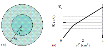

Figure a below shows two concentric circular regions in which uniform magnetic fields can change. Region 1, with radius r1 = 1 cm, has an outward magnetic field 1 that is increasing in magnitude. Region 2, with radius r2 = 2 cm, has an outward magnetic field 2 that may also be changing. Imagine that a conducting ring of radius R is centered on the two regions and then the emf around the ring is determined. Figure b gives emf as a function of the square R2 of the ring's radius, to the outer edge of region 2. The vertical axis scale is set by s = 24 nV.
Two-part figure: (a) two concentric circles with radii r1 and r2 shaded as regions; (b) graph of emf (µV) versus R² (cm²), a line starting at the origin with a steeper initial segment, marked with ℰs on the vertical axis.

I don't think there are any equations for this problem.
I know that once I find part b, if it is 0, then for part c B2 is remaining constant. If B2 is positive then the anwser for part c is that B2 is increasing. Finally, if B2 is negative in part B, then part c will be decreasing.
I think for part A it is just a matter of looking at the graph and counting how many nV there are at each distance of the ring. I'm not really sure where else to go from there.
Any help is appreciated, thanks.
The equation (yes, there is one) relevant to this problem will be in your physics textbook. Look for "induced emf" or "faraday's law" or "induction", either in the contents or index.
Okay great, I found Faraday's Law (E = -d(Magnetic Flux)/dt).
I will try to work with this and see if this gets me any closer to a solution.
Thanks
