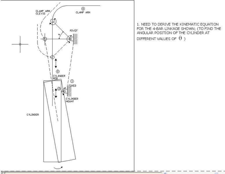

Looking For Help to derive the kinematic equation for the 4-bar linkage shown; (to find the angular position of the cylinder at different values of theta )

Here i attached the schematic diagram of 4 bar mechanism.
We are working on design automation for fixture design for that purpose we need to solve this kinematic equation.

sir i can't able to view my question that's y i added there, please help me to view my question to all viewers

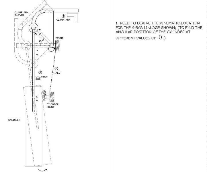

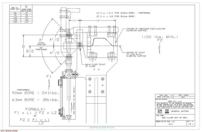

here i have attached the free diagram as well as main diagram, from that we need to find the equation from the given data, please see both the attachment, now totally i have attached 3 drawings in jpeg file...
