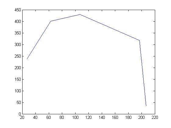

is there any corrolation between thermal conductivity coefficient and molecular wieght Mw
according to the units [K] W/(m·K) it is independant of mass units (kg or g/mol etc)
in my question i am asked to show with a graph, but i have no idea what graph they are talking about
Put thermal conductivity coefficient of Y axis and Mw on X axis and plot data points for any number of substances (the more, the better). Either there will be some obvious correlation or not.
You may also try to make a plot for some selected group of substances, like alkali metals, or metals in general.
using
Al; Cu; Ag; Au; Pb
this is the graph i got
but how do i know if there is any correlation, i know its not linear,
