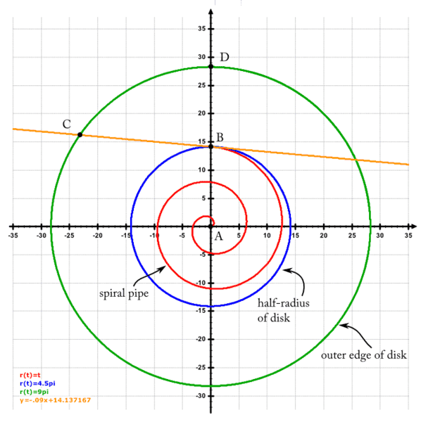

Thanks for the posts everyone, I have to read them carefully, but in the meantime I've attached a sketch and another description here:
The fluid travels along the spiral pipe, which is fixed to the disk, which rotates at constant angular velocity in a clockwise direction. An observer in the rotating reference frame sees the fluid element moving in a spiral path from A to B along the spiral pipe, while an observer in the inertial frame sees the fluid element moving from A to B in a straight line along the y-axis. As the observer in the inertial frame can see, since the fluid element moves at constant speed in a straight line, it experiences no acceleration, and in particular, zero total acceleration in a direction normal to its direction of movement. I.e., it experiences zero tangential and zero radial acceleration, its radial velocity is constant, and its (absolute) tangential velocity is always zero. (Its relative tangential velocity, i.e. that seen by the rotating observer, is increasing.)
When the fluid element reaches B, the local tangential direction of the spiral pipe is described by the orange line BC, while its path, as seen by the observer in the inertial frame, is still following along the y-axis. It enters a second section of pipe and accelerates instantly to infinity (if this abstraction is confusing, perhaps I should just say it instantly accelerates to a very high velocity along the pipe). In order for the fluid element to experience no acceleration normal to its direction of motion anywhere along its path from A to the outer edge of the disk (in particular, including at point B), should the second section of pipe follow BC or BD? (Or, if we consider the case of a very high velocity rather than infinite, should the second section of pipe be closer to BC or BD?)
That is, the fluid element should not be "pushed up" against one of the sidewalls of the pipe more than the other -- the fluid should experience no centripetal or Coriolis acceleration, the only acceleration it experiences should be parallel to the direction of the pipe. (Note two things: at B, the motion of the fluid element (as seen by the stationary observer) is along the y-axis -- it's all radial, there is no tangential component -- while the direction of the fluid streamline is not radial, it's along the tangent described by BC.)

Having thought about it a bit more, it does seem like the second section of pipe should follow the radial line BD (referring to the sketch I attached above), but I'm still on the fence, so to speak. Consider what happens when you give the fluid element a higher radial velocity between A and B -- it inscribes a "wider" Archimedean spiral, i.e. a spiral with larger distances between the turnings. And when the velocity becomes very high, the spiral becomes so wide as to approach the radial direction. Also, obviously, if the fluid element travels in a straight line from A to B, then unless it is subjected to a tangential acceleration at B, it will continue to travel in a straight line from B to D.
So it seems intuitive that, if the fluid element travels at a certain radial velocity between A and B, and then travels at a very high radial velocity between B and the edge of the disk, that it should take a very wide spiral path approaching the radial line BD. (When the velocity is infinite, the spiral would be "infinitely wide" -- i.e., it would be the line BD.)
But what's unclear to me is how taking the path BD satisfies the objective of the fluid element not being accelerated against the sidewalls of the pipe at any point, including B. Recalling the example of the sliding puck, the objective was to slide the puck between the two spiral fences without it touching either of the fences that are on either side of it; at B, the puck accelerates to a very high velocity (or infinite, if you prefer) and so the fences take a path closer to BD. So, all along its path from the centre of the disk to the radius, including at B, it never touches the fences -- the puck experiences zero total tangential acceleration along its path.
The goal with the fluid is similar -- to send the fluid element down the pipe without it being pushed up against one sidewall of the pipe more than the other. But at B, the direction of the streamline is tangential to the pipe, so that's why it also seems to make sense that the fluid should accelerate in a tangential direction BC...

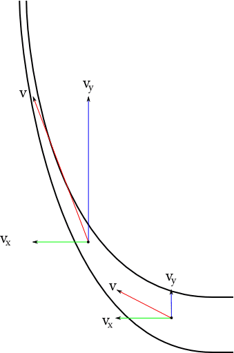

This is a sketch of a situation that I think has some similarities with my last example (which referred to a logarithmic spiral pipe). A fluid element flows along a curving, narrowing pipe. In order to maintain a constant velocity in the x direction, it has to accelerate with respect to the pipe, meaning it has to accelerate in the y direction.
