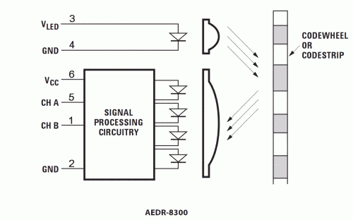

That was my first thought when thinking about a way to measure CuriousG44s springs displacement. But that would require attaching wires that would possibly interfere (?). So I was thinking maybe some sort of linear optical encoder. There would be several ways to do it. The simplest would probably be hanging an encoder from the spring (note: there would be some initial stretching of the spring but since the displacement is linear it might not be a problem.) Then use an LED to reflect some light off the encoder and count the number of lines on the encoder. You could make the encoder resolution (lines/inch) to suite your needs. Here's how the concept works:
