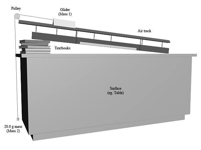

idlackage
Determine the angle of incline on https://www.physicsforums.com/attachment.php?attachmentid=30517&stc=1&d=1291856979" frictionless air track.
Acceleration = 0.147 m/s2.
The answer is supposed to be 4.10°.

Not only do I not know how to solve that final equation, I'm also sure the answer will be wrong. I really don't get how to properly go about this question.

Stop!. This equation is wrong. The normal force is along y (as you correctly point out) and does not belong in the x-equation. Furthermore, the tension is up the incline and the component of the weight is down the incline, so they must have opposite signs.

Thank you! I omitted Fn and changed the equation to this:

The equation from the second FBD is also incorrect. The weight and the tension are in opposite directions. When you fix it, make sure that the direction of the acceleration is consistent between FBD1 and FBD2.

That looks about right considering round offs. I got 3.55o.
*** On edit ***
Note that according to your drawing, arcsin(0.162/2.28) = 4.09o. If that's not close enough, you may have to explain the discrepancy.
