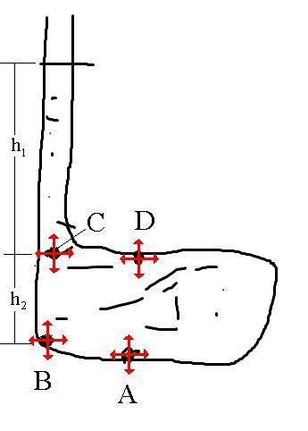

At any point (A, B, C or D), and for that point only, the pressure is the same in all directions (red lines).
At point C:
[tex]P_{C} = P_{o} + \rho gh_{1}[/tex]
Where [tex]P_{o}[/tex] is the atmospheric pressure.
At point B:
[tex]P_{B} = P_{C} + \rho gh_{2}[/tex]
Or:
[tex]P_{B} = P_{o} + \rho gh_{1} + \rho gh_{2} = P_{o} + \rho g \left( h_{1} + h_{2} \right)[/tex]
At point D, because it is at the same level than point C, their «left» and «right» pressures must be equal. Therefore:
[tex]P_{D} = P_{C}[/tex]
For point A, two methods can be used. Method 1 the same as the one for point D, for the same reason:
[tex]P_{A} = P_{B}[/tex]
Method 2 is the following:
[tex]P_{A} = P_{D} + \rho gh_{2}[/tex]
But, we already established that [tex]P_{D} = P_{C}[/tex] and [tex]P_{C} = P_{o} + \rho gh_{1}[/tex], So:
[tex]P_{A} = P_{o} + \rho gh_{1} + \rho gh_{2} = P_{o} + \rho g \left( h_{1} + h_{2} \right)[/tex]
Or:
The pressure at the bottom is always the weight that is supported PLUS the pressure over that weight. Because, in our case, there is no lateral acceleration, there is no «weight» to be supported ([tex]g = 0[/tex]), so the term [tex]\rho gh = 0[/tex] when we look at it «sideways».

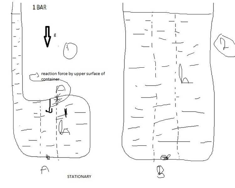

the answer to you question was given by pascal himself
In the first Diagram:
The molecules of water are in continuous motion. During their motion they hit the upeer of of the container.
According to Newtons third law "for every action there is an equal and opposite reaction".
so the upper surface of the container will exert a force on the liquid so the net force on the bottom of container will be the "weight of the liquid plus" the reaction force by the upper surface of container
so from this we conclude that the pressure at the bottom of both container will be same.
