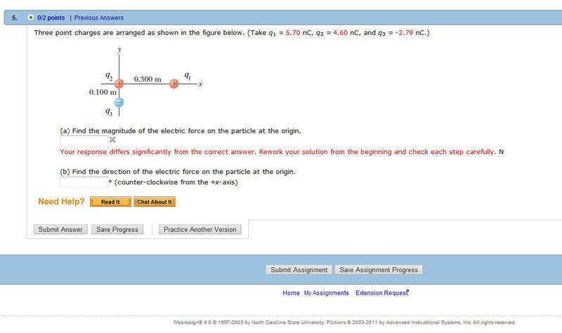

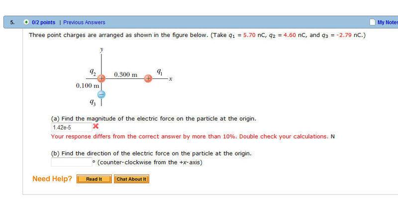

Three point charges are arranged as shown in the figure below. (Take q1 = 5.70 nC, q2 = 4.60 nC, and q3 = -2.79 nC.)
(a) Find the magnitude of the electric force on the particle at the origin.
(b) Find the direction of the electric force on the particle at the origin.

I didn't do the arithmetic so I'll assume its right, but you must still add those two vectors to get the sum of the forces on q2. Then convert to polar coords (magnitude and direction) because the question wants that. It looks like you entered in the 'magnitude' box only the magnitude of one of those vectors.
