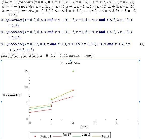

Hi,
I'm working on an assignment which requires me to superimpose the graphs of 10 different discontinuous functions on the same graph. Can someone please explain step-by-step how to do so in MAPLE? By the way, I have absolutely no experience in any computer programming in any form and I've never used Maple before...sigh.
The horizontal axis is time (t) and the vertical axis is foward rate (f(t)).

So I did some search on the internet and tried to modify some MAPLE code and I got something like the following.
And now I have some troubles...
1) In the legend part, I don't know why but there is a label "Points 1". How can I remove it from the legend?
2) How can I change the "color" of the curves for each day? (e.g. I want blue for Jan 17, purple for Jan 18, etc., and I need 10 clearly distinguishable colors in total.)
Please help! Anyone?
So I typed in 7 of the piecewise functions, but Maple refuses to overlap/superimpose more than 6 functions on the same graph, how can I fix this problem? Is it possible to overlap more than 6 functions on the same graph in MAPLE? Does anyone know?
Help, please!
