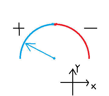

So here is the scenario (see attachment) - I have a semicircle wire (radius R=15.9cm) which is made of insulator material , the semicircle consist of two combined quartercircle wires parts where one has equally distributed charge +Q and the other has -Q . Required is find the Electric field in direction of x at the origin . Q=5.33nC
My approach was as follows
Let E = 1/(4*pi*e)∫1/(R^2).dQ r
dQ=λ*ds and ds=R*dθ and i also know that unit vector r = cosθ*i+sinθ*j
therefore for the E in x direction i get this expression
E = 1/(4*pi*e)*1/(R^2)*λ*R∫cosθ.dθ
Integrating from 0 to pi ( thus taking only half of the semicircle ) and using λ as 2/(pi*r)
I get Q/(2*pi^2*e*R^2) .
Because the other half has opposite charge i can say that the Etot = Eneg +Epos
Therefore i multiply the equation by two to finaly get
Q/(pi^2*e*R^2)
If i put the values given i get as absolute value 2413 N/C for Electric field at origin of circel in the direction of x
Unfortunately it is a wrong solution :( ! What is the mistake i hv done ?? Can anyone spot it ? Thanks in advance

Hi Redoctober! :smile:
Redoctober said:
Integrating from 0 to pi ( thus taking only half of the semicircle ) …
noooo :cry:
0 to π/2 :redface:
noooo :cry:
0 to π/2 :redface:
Oh ! srrry typo error :S :S , i integrated from 0 to pi/2 .
The answer 2413 N/C is wrong :/ !
Anyone has a solution ?? :/ !
The E field for the right part of your semi circle is given by
[tex]E = \int_0^{\frac{\pi}{2}} \frac{-Q}{4\pi\epsilon_0r^2} d\theta[/tex]
While the E field for the left part is the same but with +Q charge and integrated from [itex]\frac{\pi}{2}[/itex] to [itex]\pi[/itex]. Just add these two together to get the total field.
Are you sure? An electric field is a vector, and the correct formula is
[tex]\vec{E}(\vec{x})=\frac{1}{4 \pi \epsilon_0} \int_{\mathbb{R}^3} \rho(\vec{x}') \frac{\vec{x}-\vec{x}'}{|\vec{x}-\vec{x}'|^3}.[/tex]
Of course, in the here considered case, you have to integrate along the semicircle and use the charge per length instead of the bulk-charge density. However, you should check, whether you have all the geometrical factors for you vector component right.
Vanhees is right , Electric field is a vector .
So regarding the E will be in radial direction .
For the Y axis we need to consider the j component .

i considered the +Q and -Q E vector addition
I reached to the conclusion of
|E| = Q/(4*pi^2*e*r^2) (In the direction of J
Btw : how do u write the math expressions in that style xD . my way of typing the math is silly :/ !
The final equation i got was actually correct
i made an error with the calculation that's why my answer was wrong :)
Yes, I've checked your result too. It's correct. I parametrized the line charge with help of the charge per angle:
[tex]\lambda(\varphi)=\begin{cases}<br /> -\frac{2 Q}{\pi} & \text{for} \quad 0 \leq \varphi \leq \pi/2 \\<br /> +\frac{2Q}{\pi} & \text{for} \quad \pi/2<\varphi\leq \pi \\<br /> 0 & \text{elsewhere}.<br /> \end{cases}[/tex]
Then you can use my formula for [itex]\vec{x}=0[/itex] to get
[tex]\vec{E}=\frac{1}{4 \pi \epsilon_0 r^2} \int_0^{2 \pi} \mathrm{d} \varphi' \lambda(\varphi') \begin{pmatrix} -\cos \varphi' \\ -\sin \varphi' \\0 \end{pmatrix}.[/tex]
Integrating over the two regions gives finally
[tex]\vec{E}=\frac{Q}{\pi^2 \epsilon_0 r^2} \vec{e}_x.[/tex]
