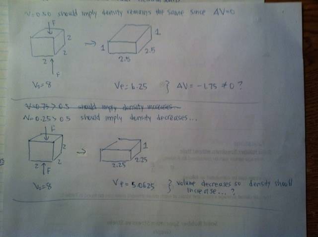

Alright so here calculated what the volume change would be for when Poisson's ratio < 0.5. It told me that the volume would decrease which implies that the density increases. But according to the lecture notes this is not true. Instead when the ratio is < 0.5 the density decreases...
Note: I also calculated for the volume when Poisson's ratio = 0.5, which according to the notes there should be no volume change. But in my calculations I found there is a volume change...
What am I doing wrong?

Let a bar be stretched by εx. For a Poisson ratio of 0.5, the strains in the y and z directions are:
εy=-0.5 εx
εz=-0.5 εx
The volumetric strain is the sum of the three linear strains, and is equal to zero.
Same problem with Poisson ratio = 0.3
εx + εy + εz = 0.4 εx
So the volume increases, and the density decreases when a bar is stretched under tension and the material has a Poisson ratio of <0.5
