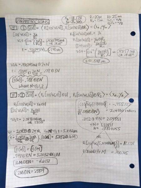

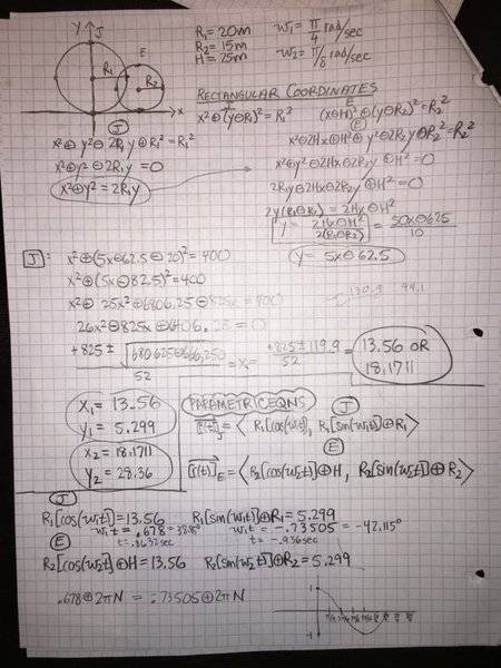

I'm trying to learn how to write in latex properly to show the work.
Can I post a picture of the notebook page and/or dry erase board with the actual work?
It's actually against the rules but if it is TOTALLY clear and utterly legible it might pass muster.
Likes LaplacianHarmonic
A bit difficult to set up the functions to find the time at which both x and y coordinates for the intersection of the two Ferris wheel come out from the 2 sets of parametric equations.
I am stuck
Hello?
these two points start at angle 0
How are you interpreting that? What angle? Is this any different from the obvious fact that when t=0 we have At=0 and Bt=0?
I cannot follow your working. Please take the trouble to type it in. That allows reviewers to target comments at individual lines.
Having equations left and right on a page makes it hard to follow the sequence.
I do not understand why you want to work in terms of X and Y, or introduce new labels for radii (they are given).
If the two points coincide at some time t, what two equations can you write involving t?
