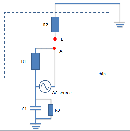

I find an interesting related to electric field when doing experiment.
I put a chip which has the following circuit inside Scanning Electron Microscopy(SEM), an electron beam is irradiating on R1.
The AC source is isolated from Earth by using a capacitor C1 and resistor R3 in the middle.
I found that the electron beam is oscillating with a frequency the same with the AC source.
So I think there may be electric field resulted which deflects the electron beam periodically.
Then I did the following experiment.

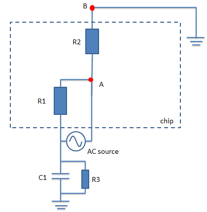

The only change I made is cutting off the connection between point A and B.
I found this time electron beam is no longer oscillating. My question is that 1. how does the oscillating electric field produced?
2. why in the second situation, there is no electric field?
I know that electric field is produced due to potential gradient in space.
I think in the second situation Point B should have a potential of 0V since it is connected to earth, Point A has a potential not equal to 0V, there is potential difference between them, why there is no electric field be produced between point A and B?

You never measure potential, only potential difference. If you use the GND as your reference potential, then any point in the circuit connected directly to GND will read 0V: you are basically putting the positive and negative voltmeter probes in the same place.
The would certainly be an electric field between A and B (through R2) in the top diagram. (You have complicated things by using "B" for two different things.) There would also be a magnetic field around the resistor and the track. The electric and magnetic field will change because the driving potential is AC.
In what way would this setup be considered to "isolate" the AC source from earth?
To me it looks like the circuit initially connects both ends of the AC source to ground through different networks ... so point B (top diagram) and the far end of R3 are effectively connected. Not so in the bottom diagram.

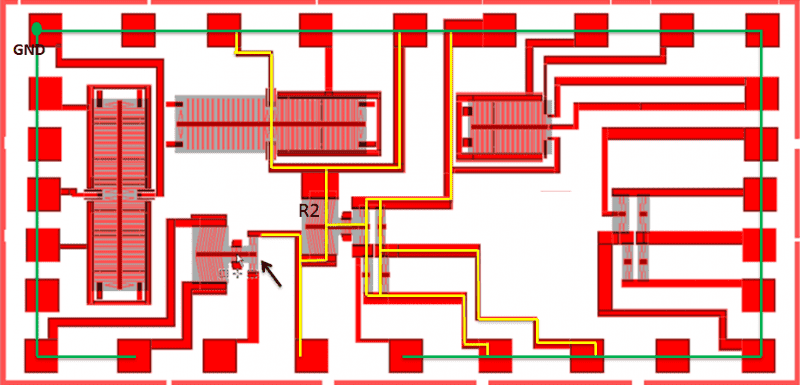

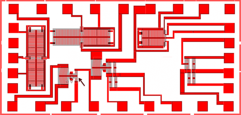

First we fabricate a chip, a MEMS chip, mainly used for mechanical testing of nanostructure. The inner design of the chip is shown below.

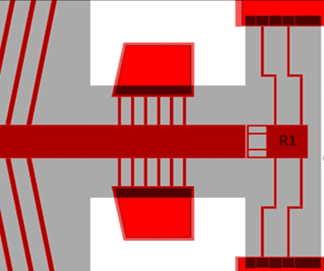

R1 I mentioned in last thread is the area which the arrow points at. Enlarged image is shown below.
R1 mechanically function as a thermal actuator, it will oscillate under AC voltage.The aim of the experiment is to measure oscillation amplitude under different frequency. The part on the left is a fixed structure, it should always be stationary.
R2:
one end of R1 is also connected to other structures as I highlighted in yellow color. I simplified them as R2. All the pins are electrically connected(green line) using conductive tape, except the two pins through which the AC voltage is applied to. I connect the upper left corner pin to ground when doing experiment.

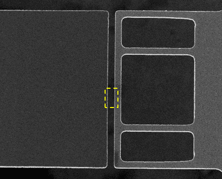

Below is the R1 under electron beam.
As I mentioned the left part is always stationary. But when I applied the AC voltage, I found the left part is also oscillating.
I think the only reason is electron beam is deflected periodically.
Right now I want to figure out what on Earth make the electron beam deflected.
