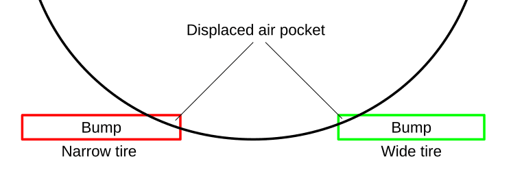

Here is what I want to know specifically: if I replace my 5cm wide rear tire with a 6.25cm wide tire, how much can I increase the inflation pressure to obtain the same comfort?
I realize "comfort" is not a quantifiable measurement, maybe shock absorption characteristics is better. Perhaps it can only be compared for one particular kind of shock? Representative for my use case would be riding over a +1cm step change in surface height at 10m/s. Wheel diameter is 723mm for the 5cm tire and 749mm for the 6cm tire.
Background facts that I am aware of:
- tire deforms so that load on the wheel equals contact patch area * inflation pressure (e.g. 15 cm^2 contact patch for 450N at 300 kPa),
- bumps cause the tire to widen locally so that the outer edge moves inwards while preserving volume.
Any ideas? Remarks?

What do you think of these propositions?
1. the amount of shock you feel over a bump is proportional to the volume of air that the bump must displace within the tire (call it air inertia),
2. a wider tire will place the same contact area against the bump, cfr. the static scenario but with the load now caused by the inertial effect of riding against the bump, but needs to deform less to do so,
3. the reduced deformation means reduced volume of air displacement,
4. the reduced deformation means the tire will "climb" the bump earlier (axle rises sooner).
This would mean less thud (reduced perceived sharpness) but more wallop (throws you up from the saddle harder) in entirely unscientific terms. Propositions 3 and 4 are a bit dodgy though, I can't immediately see what the effect of the tire width would be on the depth of the dent made by the bump, and therefore on the volume of the triangoloid-meets-torus indentation. See my assumed deformation as viewed side-on below.

I'm confused because all of that sounds backwards to me: wider tires run at LOWER pressure and provide MORE comfort than narrower tires. You seem to either be saying the opposite or trying to undo the advantage of the wider tire (Why would you do that?). Am I understanding right?
Either way, you may run into an issue that the wider tire is unable to handle the pressure increase you want to apply.
@russ_watters you are correct, I intend to undo the comfort advantage of the wider tire in exchange for lower rolling resistance. If the increased width brings a comfort advantage at least... Right now it's not even confirmed that a wider tire at the same pressure is more comfortable, but I suspect it is.

Note that the larger wheel diameter will reduce the shock of going over bumps much more significantly than the width of the tire, as it will increase the duration of the periods of transitions over bumps. With a larger diameter wheel, the same displacement occurs over a longer period of time.
