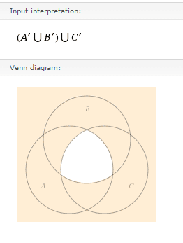

Here are my solutions. Of course I want to know if I'm correct or not, but I basically need some help with g, h and k. I can't quite understand these expressions and when I try to turn them into mathematical expressions I end up with nonsense. I also used Venn diagrams to understand each event better.

h) This one seems easier to understand if I translate it to "Three events can't happen at the same time, so it's simply (A∩B∩C)' or (A'∪B'∪C') from De Morgan's Law. The Venn Diagram of this also makes sense to me.

Hmmm, so g would look like h, only without the striped parts, right? And my "boolean" expression should be correct if we replace AND with ∩, OR with ∪ and NOT with '.
About j, now. We usually refer to the universal set as S. Is this the answer? Because "3 events at most" means 3 or less and the events are exactly 3? In that case the expression should be (A∪B∪C)∪(A'∩B'∩C').
I still think it more fruitful to compare g with d.
You mean because they're each other's complement? I can't see any other resemblence.
