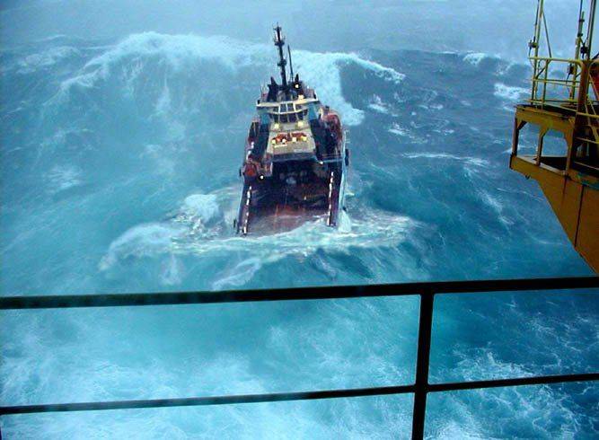

I've always thought that Russian WIG craft was pretty cool. However one of the downsides to the practicality of such craft is you need a pretty flat stable surface for them to work well. Imagine that thing trying to cross the North Atlantic in a storm with 30-50 ft swells!
[PLAIN]http://media.oceaninspire.com/2010/09/waves.41.jpg
[PLAIN]http://media.oceaninspire.com/2010/09/deadliest-catch11.jpg

dtango, cool pics of some serious sea states in the North Atlantic! Fortunately, the oceans host hundreds of bouys which monitor, among other things, sea states. Flying around such troubled areas is easy.
