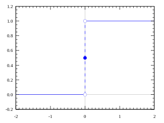

A good thing to try is to invent some discontinuous functions yourself and to see how the rules fail. One of the most famous examples is the Heaviside step function:
So this function is defined as a function ##H:\mathbb{R}\rightarrow \mathbb{R}## such that ##H(x) = 0## if ##x<0##, ##H(x)=1## if ##x>0## and ##H(0) = 1/2##. You can see from the graph that the function is not continuous and that there is a problem in ##0##. Does this function satisfy
[tex]\lim_{x\rightarrow 0} H(x) = H(0)[/tex]

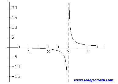

Here's another function:
Is this function continuous? Where is the problem? What rule doesn't it satisfy?
Another one:
This function to be discontinuous. The reason is of course that the function is undefined at ##x=3##, so ##f(3)## is not defined. According to your definition, for the function to be continuous at ##3##, it must be defined there.
