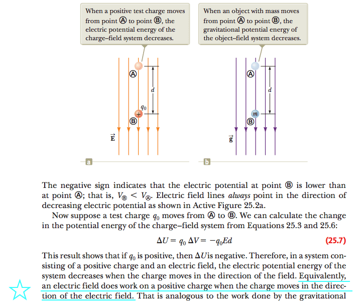

Per the photo: so could we also see this as the charge does work on the electric field when we consider the perspective of the charge? My apologies if I am being slow here but this topic of work and negative and positive signs have been confusing me for quite some time and I really want to put the nail in the coffin. If you or anyone knows where I can find a detailed explanation, I would be indebted if you could share it.

There isn’t any secret here. This is completely general.
Simply define what your system is. Write your equation W=whatever. Assume that W is positive and see if the energy of your system increases or decreases. If a positive W makes the system’s energy increase then W is work done on the system.
It doesn’t matter if the system is a charge, a field, a car, or a pot of water.
