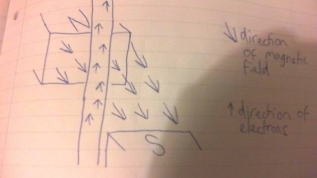

Why does cutting the lines of the magnetic field cause electrons in the copper wire to be deflected in the right direction? When the wire goes through the magnet it is at a right angle to the magnetic field-
See what I mean? So how do the electrons get pushed up vertically by a magnetic field that seems to be horizontal?
That gives maximum induced voltage. At other angles, you still get induced voltage, but of lesser magnitude.
Direction of movement, direction of magnetic lines, and the induced current are all vector quantities and are all perpendicular to each other: an x-y-z 3-dimensional space.

Ask the creator, you mean God? Come on, surely one of the mere mortals on here has the answer? :biggrin: But seriously though, isn't there a theory to explain this?
You seem to be asking about the origin of the interaction of electric and magnetic fields. It turns out that they are one and the same, depending on your relativistic frame of reference. I would look into electromagnetism and relativity. Try here: http://physics.weber.edu/schroeder/mrr/MRRtalk.html
Are you looking for something like this? http://en.wikipedia.org/wiki/Lorentz_force
The lorentz force describes the force on a charged particle by electromagnetic fields. A charged particle feels a force in a direction that is perpendicular to a magnetic field line. I would hit up the above article and browse around to learn more if you are interested.
