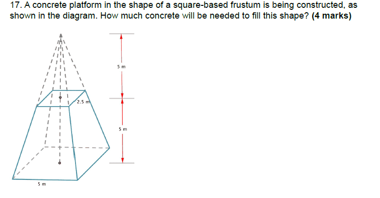

Finding volume of Square pyramid

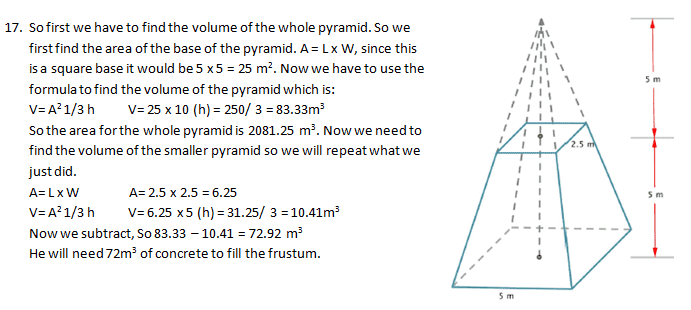

V= a21/3 h
I may be wrong or right I don't know. I'm pretty sure I did it right.
What is 72.92 rounded to two significant digits?
O its 73cm my bad
other then that is the way i did it correct?
Yes.
Ok thank you.
