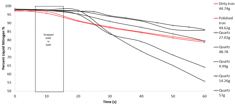

I worked on a lab experiment that was meant to measure heat capacity but left me with some other questions. The students measured the mass of a cup of liquid nitrogen as it boiled off, recording mass vs time. Then they drop a solid object into the bath, one experiment with a small bit iron bar, then with a piece of quartz in a separate run. The boil off rate increases for some time then returns to the first rate once the system equilibrates. Given the latent heat of vaporization of LN2, they then successfully calculated the Specific Heat of the iron C = ~450 J/kg°C and quartz C = ~730 J/kg°C.
My question is in regard to the rate at which the objects cooled assuming when we measured grams/ per second of LN2 that is analogous to the rate of cooling. The mass of these objects were roughly the same, so I expected the iron to cool fastest since it has a higher thermal conductivity, but the quartz was significantly faster every time. I can guess at a few things. Maybe it was geometry? the iron bar was smooth and the quartz was porous and roughly shaped with more surface area of contact? or maybe the iron did cool faster but the thermal conductivity decreases as it cools. maybe the rate was driven by the LN2 and the stored heat, not the transport propertied of the materials.
What drives the rate in this scenario?

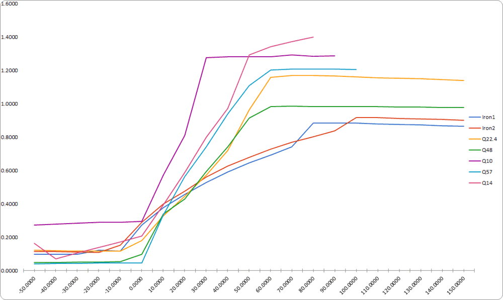

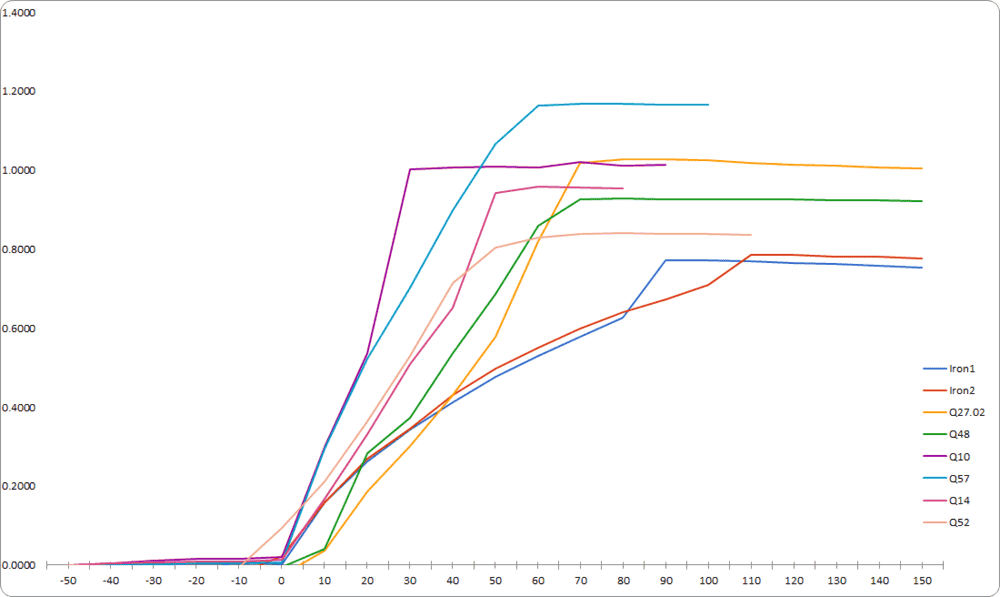

Make a plot of ##\frac{\Delta N2}{MC}## versus time for all of the samples, where ##\Delta N2## is the absolute amount of nitrogen that have evaporated up to time t, M is the mass of the sample, and C is the sample heat capacity. What do you obtain?
Likes tempneff
I get a plot that looks like this (if I did it right). I'm not sure what to make of it though. Kinda looks like some the quartz samples were not completely cooled by the time I stopped taking data. What am I missing?
245206
This plot tells us several things. First of all, it looks either like (a) none of the cases reached steady state or (b) there was nitrogen evaporation occurring (at roughly a constant rate) even before and after the samples reached steady state. I think the latter is most likely. So we should subtract the background evaporation rate times time divided by MC from each of the curves. The background evaporation rate should be the same for all the cases. From this data, what do you estimate that to be?
Secondly, the final amount of N2 that is lost as a result of heat exchange with the samples should be given by: $$\Delta N2_{final}H=MC(25-(196))$$where H is the heat of vaporization of N2 (200 J/gm). If we rearrange this equation, we obtain: $$\frac{\Delta N2_{final}}{MC}=\frac{(25-(-196))}{H}=1.1$$ Therefore, all the curves should asymptote to a value of 1.1

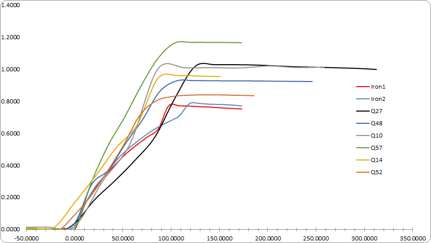

Here is the plot after correction. I think your assessment makes sense. Do you think that the dependence of boiling regimes (specifically Transition Boiling) on surface area and roughness could explain why the rough quartz is less restricted. Do we agree that, from the data, there is a trend in the size of the samples with the transfer rate? Maybe then the larger masses simply provide a greater surface area for transfer?
Nicely plotted.
But, whoa pardner. Let's take a step backwards and slow down.
Before we address the time response, we need to get a better understanding of why the results don't all asymptote to 1.1. The iron seems to be asymptoting to 0.9 and the quartz seems to be asymptoting to about 1.2. The quartz results could be improved by lowering each of the curves by the values shown at time t = -10 min, to remove the initial offset that was there before the sample was even inserted. Please do that next. I think it will result in all the quartz curves better asymptoting to 1.1 (the expected value). However, it will also lower the iron curves a little more. Let's see what we get when you do this.
Meanwhile, I am going to do a heat transfer analysis to analyze the problem mathematically. This will enable us to evaluate the transient behavior better (and will tell us how to next properly scale the time parameter).

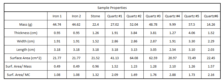

The porosity of the quartz samples is only about 50-60%, so the ratio of their surface areas to their masses is higher than the iron. Please calculate the surface area to mass ratios of the various samples, including the iron, assuming that the quartz samples have the same rectangular parallelepiped shapes that you have listed. Then calculate the ratio of surface area to MC for each sample. This will give us an idea how to scale the curves in the time direction. Thanks.
Likes tempneff
Incidentally, the temperature change of the samples is 220 C, not the 170 C indicated on the spreadsheet.
Likes tempneff

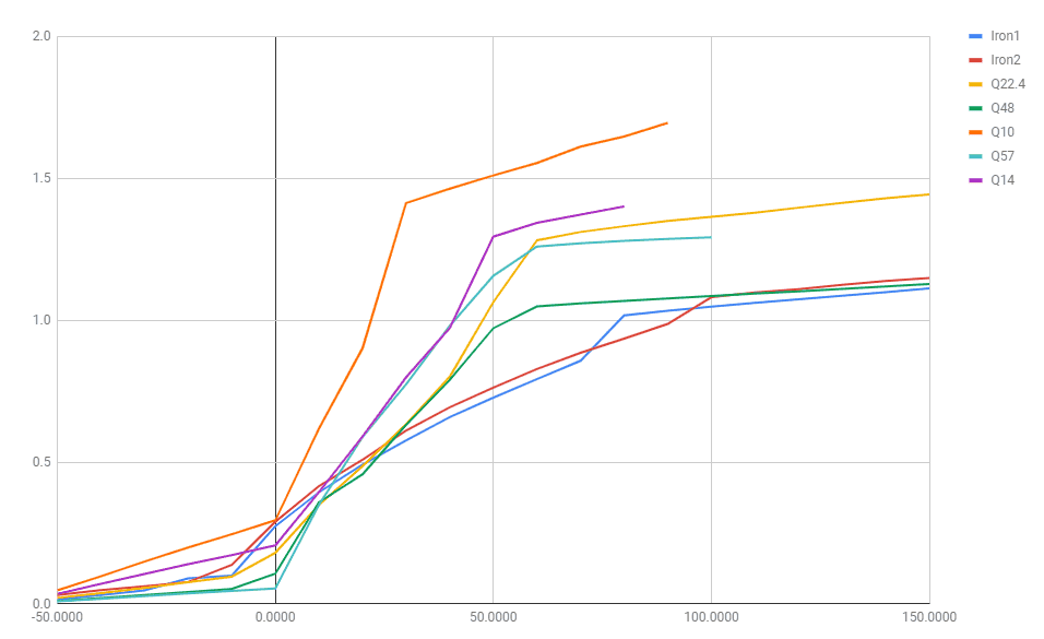

Yes, I corrected that delta T error. Here is the shifted plot you asked for.
245296
Shouldn't Quartz #1 be 27.5 gm, rather than 22.4 gm? And what happened to Quartz # 2 with 52 gm?

I think a picture is emerging now.
The heat transfer analysis on the samples goes like this. The transient heat balance on a sample is given by
$$MC\frac{dT}{dt}=-hS(T-T_N)$$ where S is the surface area of the sample, ##T_N## is the nitrogen temperature, and h is the heat transfer coefficient between the sample and the nitrogen. In this analysis, we will assume that the heat transfer is dominated by the resistance on the nitrogen side of the boundary and that h is roughly constant in time and independent of the type of sample. The solution to this equation, subject to the initial temperature condition of the sample is:
$$T=T_N+(T_0-T_N)e^{-\frac{hSt}{MC}}$$where ##T_0## is the initial sample temperature. From this it follows that the amount of heat given up by the sample up to time t is given by:
$$Q=MC(T_0-T_N)(1-e^{-\frac{hSt}{MC}})$$ This must be equal to the amount of nitrogen lost up to time t time the heat of vaporization H:
$$\Delta N_2H=MC(T_0-T_N)(1-e^{-\frac{hSt}{MC}})$$or, rearranging,
$$\frac{\Delta N_2}{MC}=\frac{(T_0-T_N)}{H}(1-e^{-\frac{hSt}{MC}})$$
This is basically the relationship we have plotted on our graph, aside from the scale factor ##\frac{hS}{MC}## on the time.
OK so far??

Yes the number from Quartz #1 was wrong, an accident. Quartz #2 is back, also an accident. A new plot and a table of ratios are both below.
OK so far??
Yes, it makes sense. Is it fair to say that the resistance on the nitrogen side of the boundary functionally determines the rate of transfer.
245350
245351
Yes, it is correct to say that the resistance on the nitrogen side of the boundary (together with the surface area S and MC) functionally determines the rate of heat transfer.
The calculated values of the Surf. area/MC are extremely revealing. In the equation we wrote, since the heat transfer coefficient h is assumed constant, the higher the value of S/MC, the more rapid the rise in ##\Delta N_2/MC## should be. And the values of this parameter for the quartz samples are much higher than those of the iron samples. Therefore, this is the reason they rise much more rapidly.
S/MC is essentially a scaling parameter on the time. If we multiply the time by this parameter for all the samples, theoretically, it should cause all the curves to superimpose onto a single curve when we replot the graph using the scaled time as the abscissa. Of course, in the case of the quartz samples, the surface area is highly uncertain due to the very irregular shape, and the values of the area obtained assuming perfect rectangular parallelepipeds is probably not a good approximation to the actual surface area. Still, if we multiply the times for all the quartz samples by a factor of about 2, it would put the quartz curves pretty close to the iron curves.
So, I believe that we have identified the correct mechanistic explanation of the observed behavior. Maybe, if you feel like it, you might try scaling the times for the samples by their individual S/MC values and redoing the plot just to see. But I think that, at this point, it would not add much to better quantify the comparison.

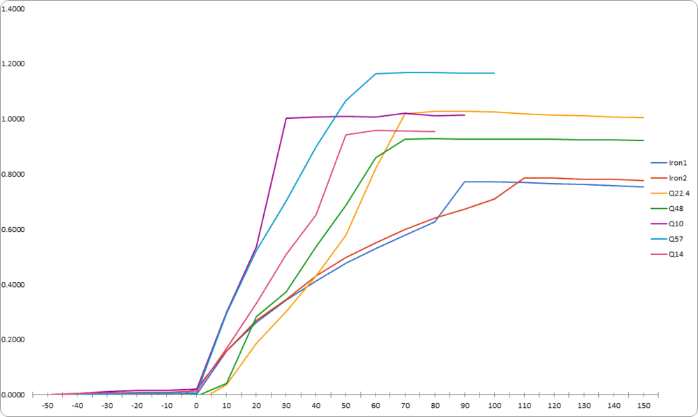

Well I'll be darned... Superposition is a lot to ask in the real world, but I say this is getting close. Thanks for working through this with me, now I can sleep at night.
