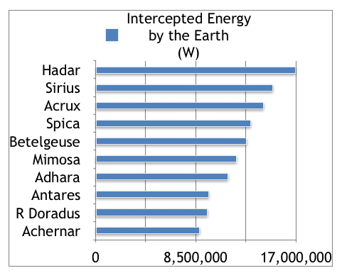

I'm not sure why I like this thread, but I do.
Here are my results so far:
Likes Drakkith
Why isn't Sirius top on the list? Shouldn't the brightest star also have the largest amount of energy falling on the Earth?
Likes Anand Sivaram
I think this calculation has a mistake. As Drakkith said, I also feel that Sirius should be there on the top.
Consider this way
Total Intercepted Energy ∝ Received W/m2 ∝ L / d2
where L = Luminosity of the star, d = distance to the star
These are the values of some of the stars listed, based on Wikipedia
L = Luminosity compared to the Sun
d = distance in Light years
| L | d | l/d2
Sirius | 25.4 | 8.6 | 0.34342
Hadar Beta Centauri | 41700.0 | 390.0 | 0.27416
Betelgeuse | 126000.0 | 640.0 | 0.30761
Hmmm. After thinking about it more, perhaps the key is that some stars are visibly dim, but emit a much larger amount of light in the IR band.
Luminosity of a star is generally measured relative to L⊙ - Solar luminosity 3.828 x 10^26 W. It is normally the bolometric luminosity measured using a Bolometer.
https://en.wikipedia.org/wiki/Luminosity#Measuring_luminosity
Solar luminosity includes all EM energy including UV and IR. But, neutrino energy is not included. It is derived from the Solar constant. We could see that the Solar constant includes Solar energy in all spectrum.
https://en.wikipedia.org/wiki/Solar_luminosity
There is also a term named Bolometric correction to get bolometric magnitude from visible magnitude
https://en.wikipedia.org/wiki/Bolometric_correction
Just found an interesting paper on Basic Stellar Astrophysics
http://www.astro.sunysb.edu/lattimer/PHY521/intro.pdf
Or in the UV band.
Hadar and Sirius both have peak wavelengths in the UV.
Betelgeuse and R Doradus peak in the IR.
243832
Likes Dinoduck94, Anand Sivaram and Drakkith
