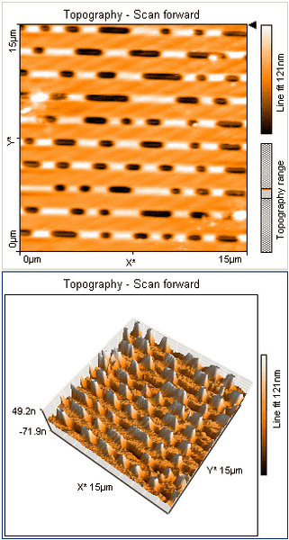

Our first idea was to see the surface of a cd-ROM to get something like this:
The main point is that since we are doing this for a lab course, we should design and assemble most of the setup ourself.

What you see here is not the surface of a CD but of the inner aluminum layer. It may be an AFM image.
You need to peel one of the plastic halves to get this by AFM.
You may be able to get a similar image by optical means without destroying the CD. Just be aware that it is not on the surface and you may need to deal with the multiple reflections in the plastic layer.

Yeah we considered that. We thougth of someway removing the plastic coating and perform the measurement only on the metal layer that has the bumps

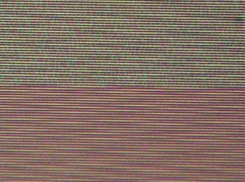

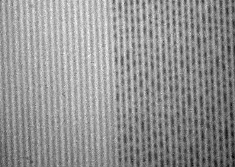

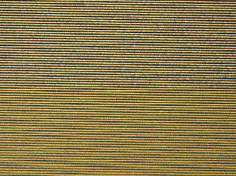

As I suspected, this is not trivial. The plastic prevents use of DIC, and the thickness of the plastic largely prevents use of high-NA lenses needed to resolve the features. Here's the best of what I could get, using a CD-ROM, because it has the largest feature sizes. I located the border between recorded and blank tracks for these images:
This is using a 63x dipping objective, broadband source:
This is using a 16x objective, reflected DIC, with the prism shoved all the way to one side and the aperture stop nearly closed to enhance contrast:
And lastly, a 16x darkfield objective:
None of these qualify as "simple and cheap"-mostly because the required mechanical stability and precision is very high (submicron). And the results are not quantitative.
