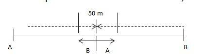

A and B leave their places and start moving towards each other. If they are 50m apart after both 2 min and 3 mins, how far are their places?
So, at 2 minutes - distance traveled by A = 2x and similarly by B = 2y
I can able to draw a diagram for this problem:
Take distance between their places as D
Speed of A = x meter /minutes
Speed of B = y meter/minutes
From here, how to proceed?

I think that the best you can do with this problem is to write an equation that represents the distance D in terms of the distance A has gone plus the distance B has gone plus the remaining 50 meters between them. You'll have one equation with two unknowns, so you won't be able to get a numeric value for D without further information.
I think the point is that at 2 minutes, they still have 50m to go to meet each other and at 3 minutes they have passed each other and are 50m apart again.
This let's you write down two equations for position which can be solved simultaneously.
@Benjamin_harsh, what does this mean?
I interpreted this to mean that one of them had been moving for 2 min. and the other for 3 min.
@Ibix interprets this to mean that after 2 minutes, they are 50 m. apart, but that they meet a minute later.
Well - that they meet half a minute later and are 50m away again at the 3 minute mark. But yes, basically.
I think my interpretation makes sense because it's soluble. But is the wording in the OP the exact question, @Benjamin_harsh? If not, please post the exact words used in your problem sheet/text book/whatever.
For what it's worth, I agree with @Ibix's interpretation.
That's a reasonable interpretation that hadn't occurred to me.
Since they are at distance 50 at both 2 and 3 minutes (constant speeds), can you see when they are at 0 distance? What does that tell you about their relative speed and, therefore, how far apart they were to begin with?
