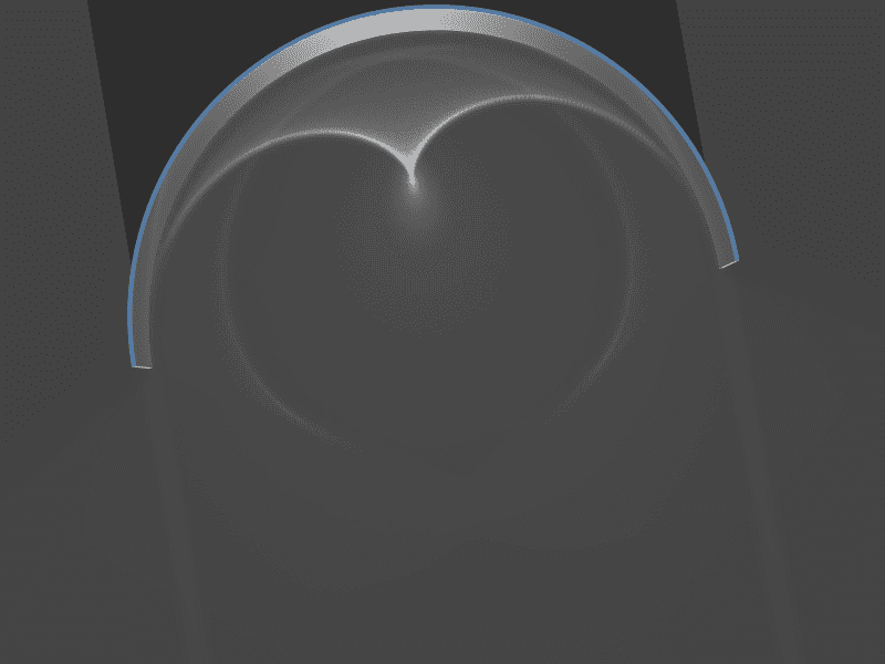

Each "volcano" is the result of massive spherical aberration of the focused light. The coffee cup is circular in shape and focuses the light similar to a spherical mirror, except only in one dimension. See the diagram of the concave mirror in this article: https://en.wikipedia.org/wiki/Spherical_aberration
Likes Anshul23
Here's a quick render of light reflected from the inner side of a semi-circle. You can get some really pretty patterns just by reflecting light off of curved surfaces
Likes Anshul23
