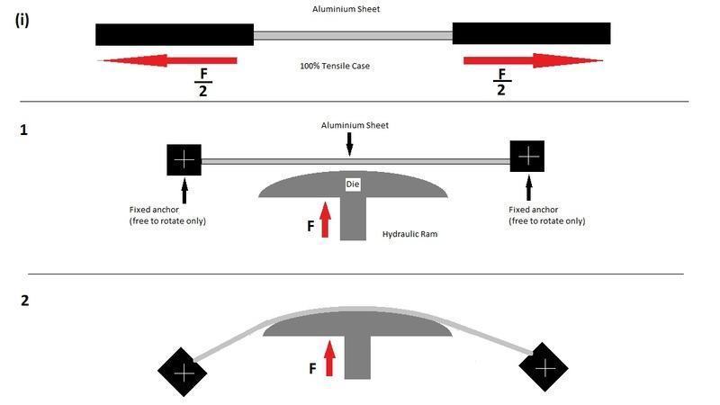

We have installed a machine for 'stretch forming'. The machine clamps a long sheet of aluminium at both ends, while a convex shape steel die is raised in the centre. The die is raised by a hydraulic system, causing the metallic sheet to stretch over it, hence forming the shape of the die. I am trying to calculate the force required to stretch the sheet, without returning to its original shape(springback), and without necking(rupture). Please see the attached image for a visual representation of the tool.

2) Formula:
The UTS=Force(N)/Area(m²)
thus Force(N)=UTS*Area(m²)
3) The above equation would lead to the force required to rupture the material but I just want the force to stretch it, so I need to be between the YS and UTS
4) from points 3&4 I now have Force(N)=((UTS+YS)/2)*Area(m²)
This is the average of YSand UTS, multiplied by the area
5) this is fine for a scenario of tensile testing(see image 'i'), but my questions are:
Q1) Is this the same force for the case I present (image '1' & '2')?
Q2) The die is lubricated prior to forming, so do I need to consider frictional force?
Q3) As the sheet is fixed on both ends, does the force that I apply with the ram replicate a force acting tangential to the sheet edges?
