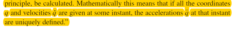

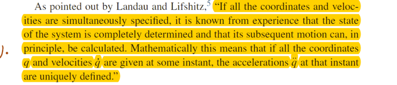

Then, what does the following book statement mean?
Pushoam said:
Then, what does the following book statement mean?View attachment 222323
It's nonsense to me. Is there a broader context that might give more information?
The statement is perfectly reasonable if it is being said within the context of Lagrangian/Hamiltonian mechanics where one presumably knows the Lagrangian/Hamiltonian (likely the case given the reference to Landau and Lifshitz). The solution to the Euler-Lagrange equation or Hamilton's equations will be uniquely determined by the knowledge of the positions and velocities at a particular instant in time. The latter is a fact about differential equations and their solutions. In the context of the OPs example, consider that in addition to the information you gave I supplement it with the knowledge that the particle is in a harmonic potential ##V(x)=x^2##. Would you agree that you can now give the acceleration at that instant of time?

What I understood is; given the lagrangian, I can get ## \ddot q ## = ## \ddot q ( \dot q , q, t)## . And then knowing ## \dot q ## and q at a given time, ## \ddot q ## could be evaluated at that time. Is this what that book statement means?
Yes, I would.The book's statement didn't specify this extra information. So, I got stuck.
Thanks for providing extra information to make it clear.
