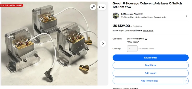

During the half-second transmit interval (followed by another half-second of non-transmission) the laser beam can be on/off modulated (OOM) extremely fast with the right equipment. Megahertz modulation rates are possible, but probably not by pulsing a laser diode on and off. The affordable laser diodes take time to "warm up" before they reach a stable internal temperature. During this warm up interval, the diode current must be rigidly controlled and ramped up to prevent destroying the laser. Because of this warm-up time, which must be repeated each time the laser diode is allowed to cool down, I plan to leave the laser diode on all the time and amplitude modulate the laser beam further down the optics train.
One idea I want to test is using a piezo-electric transducer to block and un-block the laser beam. This would occur by placing a movable vane at the plane of a pin-hole spatial filter. This filter consists of a microscope objective that accepts the incoming laser beam and focuses it to a small spot at the plane of the pin-hole aperture, used to extract a TEMoo beam from the multi-modal diode-pumped solid-state (DPSS) laser beam. That should be good for a few kilohertz with bit transitions possibly occuring every millisecond during the 0.5 second transmission interval. So, five hundred bit transitions possible per message. More if the modulation frequency can be increased.
Another OOM (on/off modulation) method comes to mind: Faraday polarization rotation between two Nicol polarizing prisms, using an optical cell holding a substance with a suitable Verdet constant. Another polarization-dependent scheme does this with high voltage instead of high current through an inductor: a Pockels cell. A disadvantage of using polarization to modulate the laser beam is half the power is immediately thrown away in polarizing the laser beam. Another problem is the high voltage required to switch the Pockels cell. And for a DIY project, probably neither scheme is acceptable. So I will try the mechanical interruption of the laser beam technique first.
This topic doesn't seem to have garnered much attention, but I did seem to observe some comments as to why it won't work, and therefore no need to waste any more time discussing how to do the impossible. When I was a working engineer, and before that, a working technician, I and many of my colleagues tried to follow these instructions: The difficult we will do immediately. The impossible will take a little while longer. It didn't always work, but we kept on trying until the money (or the time) ran out. This is my "bucket list" project. Learning how to fly an airplane is on the list, too, but this one is at the top of the list. I'll probably skip the sky-diving lessons...
