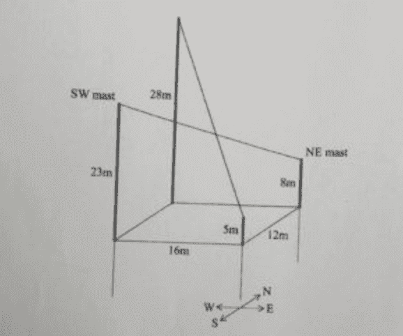

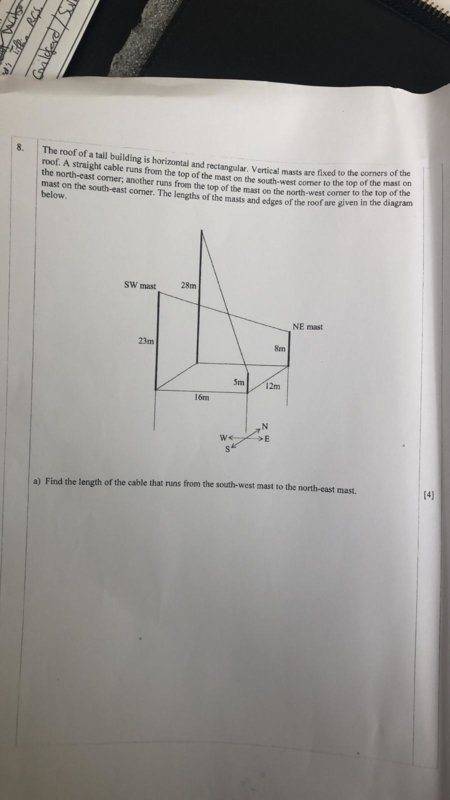

See pictures and questions attached
I can do question a but not b nor c.
Any help would be greatly appreciated

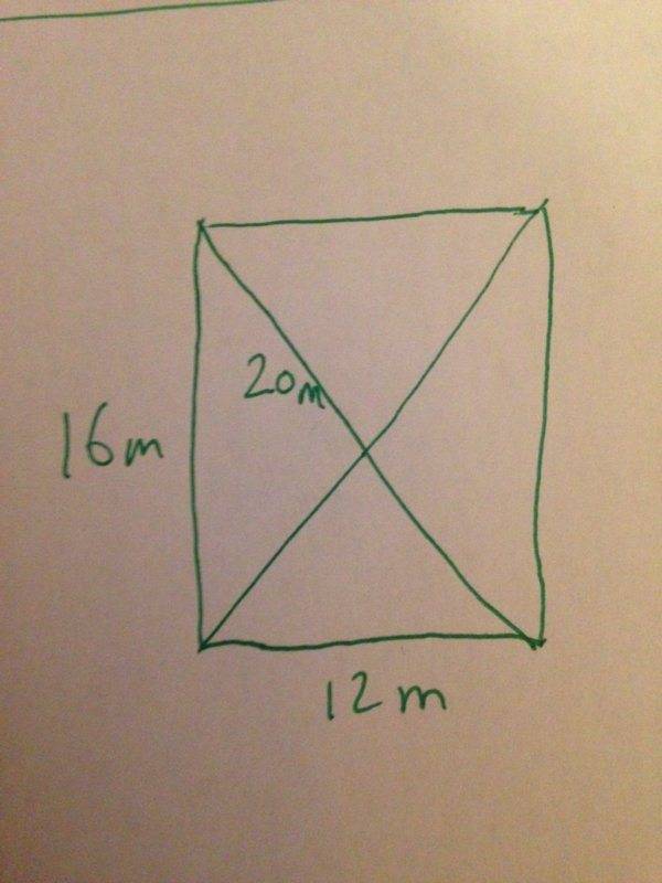

For b I drew it and get a rectangle of 16m by 12m with both diagonals being 20m and the birds must be at the crossing of these two diagonals only that I don't know how to determine how far from each other since they are not on the diagonals of 20m but on the cables one being 25m long (from question a) and the other is 30.48m to 2d.p.
Please see picture

LASTLY, Please type in the question don't take the easy way and post a poor quality picture of the question.
Amen to that!
IMG_0277.jpg is very poor quality, and IMG_0276.jpg is completely unreadable. Many members won't even bother to try to decipher images this bad.

The roof of a tall building is horizontal and rectangular. Vertical masts are fixed to the corners of the roof. A straight cable runs from the top of the mast on the south-west corner to the top of the mast on the north-east corner; another runs from the top of the mast on the north-west corner of the top of the mast on the south-east corner. The lengths of the masts and edges of the roof are given in the diagram below (see picture attached)
My question is this:
b) A robin lands on one of the cables. A sparrow lands on the other cable, perching directly below the robin. How far apart are the birds?
c) A blackbird lands on one of the cables and a thrush lands on the other. The birds are the same height above the roof and the same distance from its eastern edge. How far apart are the birds?
On the flat picture can you say anything about where that intersection point is? Relative to anything else?
Yes, the diagonals intersection must meet half way e.g. 10 m

Thanks for typing the problem statement. In the interest of completeness, part a) reads as follows.
a) Find the length of the cable that runs from the SW mast to the NE mast.​
However, the image you display is same image that @Mark44 referred to as being of poor quality. To read the values on the figure in the image, I had to display that image as full size on a computer screen, then zoom that image to 200%. Here is a snip of the figure in the image.
Natasha1 said:
I don't understand why it is 8m...
The height (above the roof level) of the north-east mast is ...
