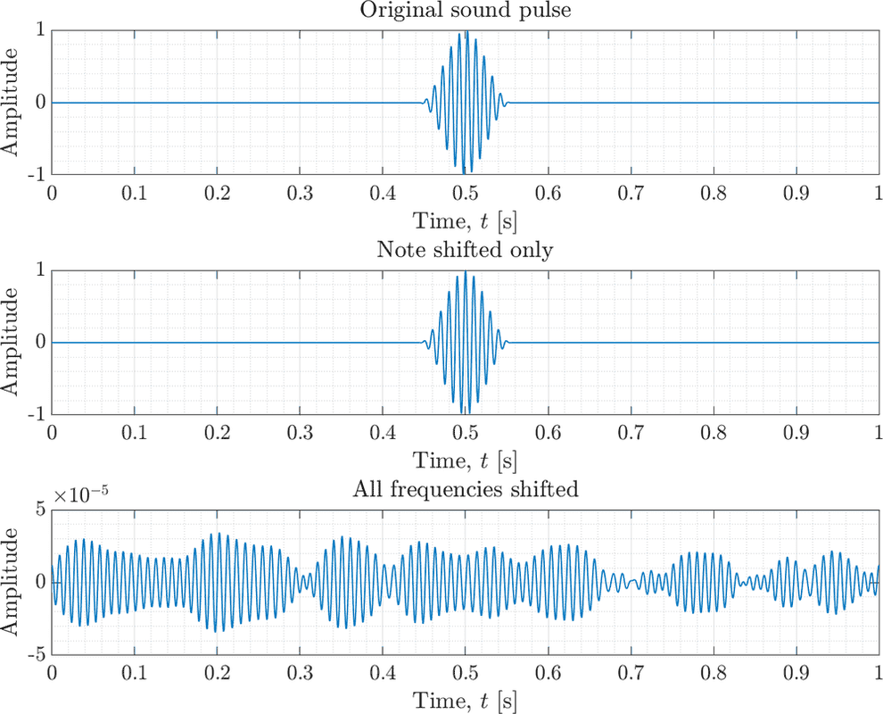

Each of those signals has an identical amplitude spectrum. The top is the original. The middle only has the note itself shifted but the carrier envelope remains the same. The bottom has a random phase shift applied to every frequency component of the signal. The top two plots would sound the same. The bottom surely would not.
Note the drop in amplitude. Since this is a single pulse, the random phase shift distributes its power over time and so it lowers amplitudes in time without reducing them in the actual spectrum. If this was a signal composed of multiple pulses and frequencies in time, that effect would be much less.

My point was not to suggest that the brain is actually physically converting those nerve signals back into an electrical time signal representing the audio, but that you as a conscious human experience the audio as a time-varying signal. It is senses as individual frequencies and experienced as something that varies in time, so that is in some ways an inverse Fourier transform. Maybe it's a metaphysical way more than an actual physical way, but my comment was intended to be illustrative rather than a technical discussion of brain physics.

Right but the issue is that changes in phase across the whole spectrum can entirely scramble the temporal behavior of a signal as illustrated above. For a signal of constant tones, the cilia in your ear aren't likely to notice anything different if one or more are phase shifted, but they will be vibrating at the wrong times if these tones start and stop as you would expect in music or speech.

I think you may have missed what I was attempting to convey. I wasn't suggesting that the cochlea was somehow scrambling things in time. My point was that a random set of phase shifts across the entire spectrum of the signal will scramble the signal in time even before it gets to your ear.[/quote]
You have stretched the response over an entire 1 second period for numerical Fourier analysis.
